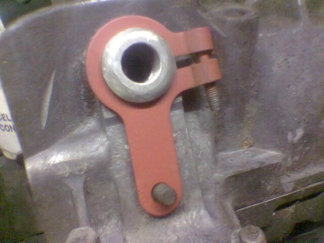

The flares at the start of my runners are stock 2.0 914 :)
I've done a bit tonight, black tape is in place of Samco turbo hose.
See how the runners are now variable? I'm trying to keep all the intake hardware modular so changes can be made without start afresh each time. They may even end-up telescopic, boost actuated, trombone style, frequency responsive... imagine that? :wink: A strut would replace the link that keeps the hoses blowing off.. Unlikely with less than .75 bar? Paint fumes and Guiness are affecting my typing.
I've just this minute considered the possibility of a 2nd batch of injectors, guess where? :wink:

MattKab wrote:I love pictures too, more than 1000 words each, so they say.
http://i37.photobucket.com/albums/e51/M ... lenum5.jpg
http://i37.photobucket.com/albums/e51/M ... erz001.jpg
Matt
Great Matt!! Keep the pictures coming :) I also thought about making it adjustable when fabing my intake! But I didn't have much time :(
I like it! My runnners is way to short :? with 1-1/2 ID would be almost 19" long to make it correct.
To little sleep and paintfumes is what inspires me ;)
I hope not it is in the plenum! It is very hard to control the fuel when you do that! Keep it as close to the port as possible ;) or at least in the runner!

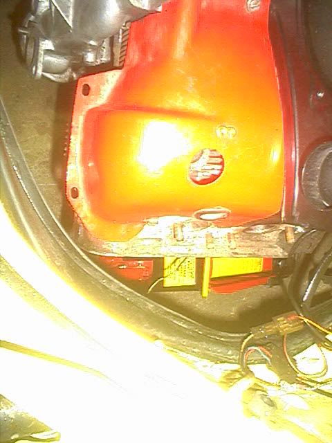

See how a T4 fits in a stock T1 FI Beetle:
http://i37.photobucket.com/albums/e51/M ... rstT44.jpg

I must say I can't visualise what you mean about the spliting IC?! :?
Are you going to make a split plenum for 1/3 & 2/4 ? :shock:
Damn it's so much room in the stock FI T1 :shock: That would make fitting a t4 so much easier :)
