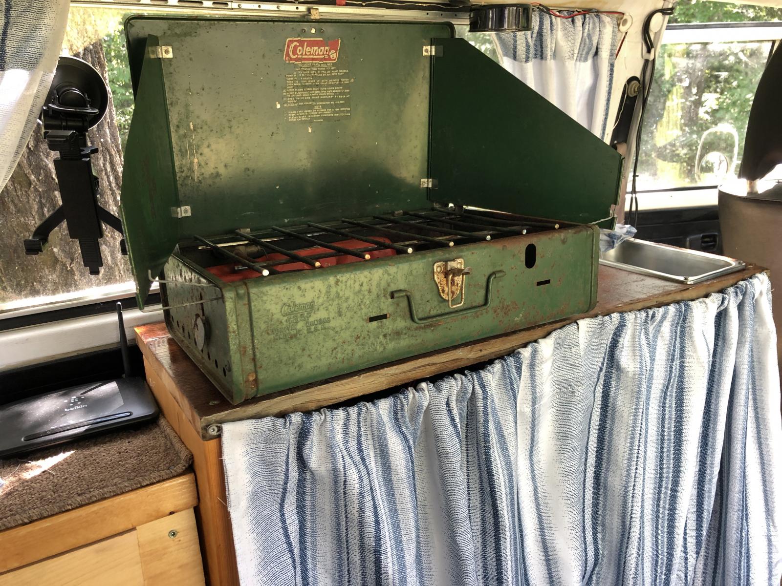

Got this for my 8th birthday in 1974. Tuned it up and it fired right off. Something satisfying about a rugged, simple, and reliable tool Smile.

i have same Coleman stove. Had it a long time. Still works like day 1. Still easy to get parts. Wish everything was like that.
