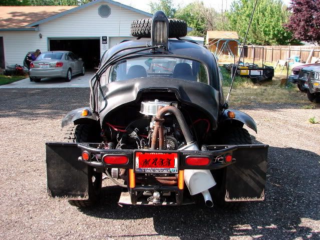

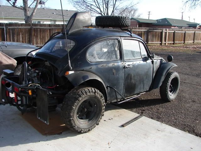

Sorry I have no pics of it when i first started it. It had the Baja glass kit on it, bald tires, stock rims, it baerly ran, had no brakes because they leaked, no interior (i drove it home the 3 miles on a milk crate & ramed the curb to stop it. LOL), none of the lights worked, stock bug exhaust, & the list goes on & on & on!!!!
It now has a 1641 with a Webber progressive carb, engal 110 cam, 009 dizy, pertronix ignition & coil, 1.5 qt oil sump, full flowed case with external oil cooler & filter, stock doghouse cooler is still in place, sand seal & alum degree pully, temp & pressure gages & Header exhaust with quiet pack, 75 amp alternator. all the rest is stock. There may be some things Ive forgotten.
I put in a 68 long swing axle & adapted the 66 drums to it. Have the parts to convert to IRS & am waiting to get a 6 rib bus trans.
I beafed up the front tie rods w/ the sway bar welded on the inside & 1 inch steel pipe on the outside.
2001 Hyandi Accent rear seat
Ford probe front seets (used them because they had a hole so I could add some race belts.)
Added double tube bumpers & made a front & rear skid plate. (Will make the rear bumper attach to the cage soon.)

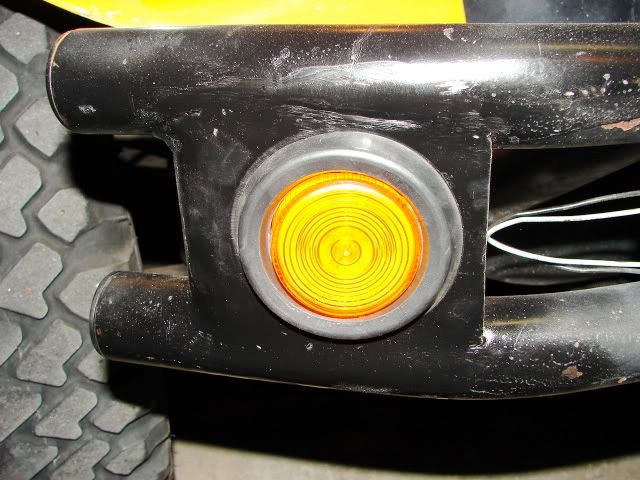

Here are the new brackets I made to mount my 2 inch signals in the double tube bumpers. I will put the new LED lights in when I can figure out how to make them blink.

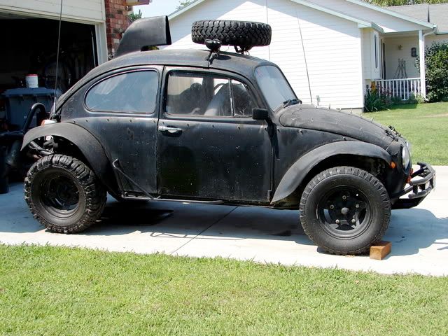

closer look at the spare tire mount. I welded it to the roof.
customized E-brake (so i could use it with my seats)
fancy rear view mirror (got it as a gift)
Early orignal VW roller pedal asembly w/ alum gas pedal.
have all New carpet, New headliner, & quarter panles to put on it.
have a New 1 pice window kit that Im going to instal.
Have some (almost) new Remington MUD BRUTE 31/10.5/15 for the rear.
Ive done lots of other custom mods to it & will post up more pics as I get a chance to take more pics. The weather here is bad so I have to take them in the garage.

That is the most original spare tire mount i think ive ever seen :lol:
Doesnt it block airflow to the cooler though? :?

Its the only place I could think of & the time to mount a 215/75/15
Its held up there without any problems for several thousand miles!
some were off road, but I dont jump the car.

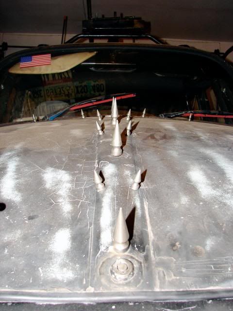

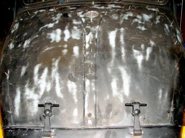

How about this for ORIGINALITY?
Best way I could think of to fill in all the air holes. (didnt hyave my welder yet.) Thats the hood from my 57 that got creased by the tard @ the gas station in OR.
& YES I always get to go first in the parking lots! Doesnt mater if its 100+ or in the single didgets! Almost no body wants to walk in front of my car!
Ill paint it gloss black (industrial coating) when get all done modifying the body. till then it just keeops getting a can or two of $1 rattle can paint from waly-world.

you won't need an 091 with a 1641. in fact a 1600 002 will work better ratio wise with the 31" tyres.
btw... you have one scary car there. :lol:

Those spikes remind me of death race...

Just realized I didnt mention that I cut the front beam & added adjusters. When i did the job I turned the adjusters so i have it lifted about 1.5 inches. (+ it has all the adjustment) I later realized that I cant realy adjust it any more. It was nearly impossible to get the arms back on...
I cant seem to get the camber out of it. I turned the ball joints to there max & I still ware the out side of the tires. Is there any thing that I can try to do to correct the problem?

Some updates to the car....
New mirrors...
new rear tires 31/10.50 15 Mud Brutes
New air cleaner
making a 4 headlight setup.
I like that idea, pretty slick. I've been trying to figure out where I was going to mount my spare, didn't want to block the rear window. This will work.

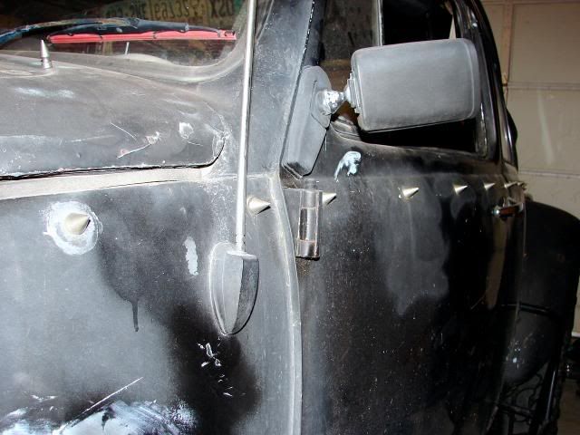

Lovin the spikes! Great idea!
Where did you get them? Motorcycle accessories???
"Road Warrior" should be your name! :twisted:
airdreams1
Posts: 429
Joined: Wed Mar 25, 2009 9:53 pm
Post by airdreams1 »
No. I bought them @ a goth shop when I lived in Phoenix.
The only draw back is when you hurt your self on them!
