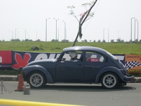

Hi there! I joined an autocross event here in the Philippines last July, August, September and October 2005, but that's in the All VW Class, but if you check the time of the Hondas, Mitsu's, Nissan's and etc... you'll be surprised that some of them are 5-10 seconds slower than the VW's, I use a 1302-s with a modified strut, sway bar, urethane bushings, strut tower bar, 1 inch adaptor, 16x7 Enkei 2 piece Racing Series rims wrapped with 205/45R16 Yokohama ES100, 1679cc type 1 engine (BLUE PRINTED), 4-2-1 exhaust system, MSD 6A, Accel Hi tension wires, Bosch 009 distributor, Weber Progressive carbs, a stock cooling system, stock 4.1 tranny with straight Shachs components.
Not Flashy but it does handle very well.
Here some pic.
Here some pic.
