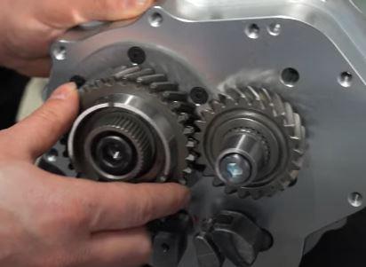

I think these are the shaft extenders:Ian Godfrey wrote: ↑Sun Jun 16, 2024 2:34 am I was unable to work out if it used an extended pinion and main shaft or if it used a different solution to a Berg 5?
And then installed, you can see the socket head screws to hold them on.

Well spotted. That will reduce the price significantly if it’s not a custom main shaft & pinion shaft. Load limits would be an interesting debate. Tricky machining operation since I assume the ends of the shafts need drilled & tapped? Those will be hard steel too.

Bit more details are available on the 5th gear conversion. An insta video shows closer details of the parts & design.
CAD cutaway shows the bolt on shaft extensions.
Price though is a lot. Circa €4.5k which is a shame.

Given the complex billet parts, its probably a reasonable price. Splined hard shaft extensions for example are not a simple piece to make.
Its not clear if the cost includes modifying the pinion shaft & the input shaft, or even if they are included (drilled & tapped for the extension pieces). But i suspect you need to get your own parts modified.
