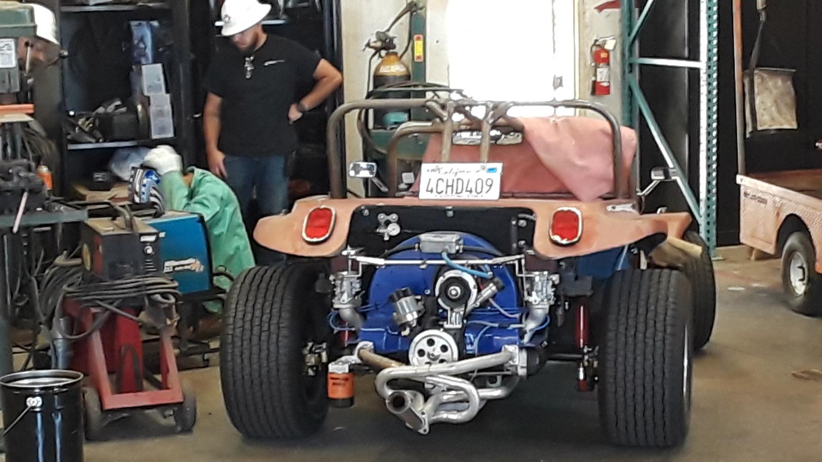

Come on in and pull up a chair. Lemme tell you about a guy with addiction problems his whole life! :lol:
For starters... I've never met a HP that I didn't like, and like most drugs... more is better! Am I right?
There's some folks who are of the opinion that a 1600 in a glass buggy is plenty. That's all you need... See above comments... that's not me. I have built a very fun fairly quick 'glass buggy with the usual "go-fast" goodies
It's an adult go-kart inspired street buggy
I've plugged in the 2276 in NA configuration
And I just struck a deal for, what I believe is, a Car Craft draw through turbo kit! :D

This will be a long term project, as the motor only has 750ish miles on it, but I wanted to share my excitement with y'all!

Shiny rims... good start.
Is this going to be street only or some off-roading.
My glass buggy, similar to yours, is for the sand and the one I am building is sand only but it is a hot rod (T touring-style) of glass buggy.

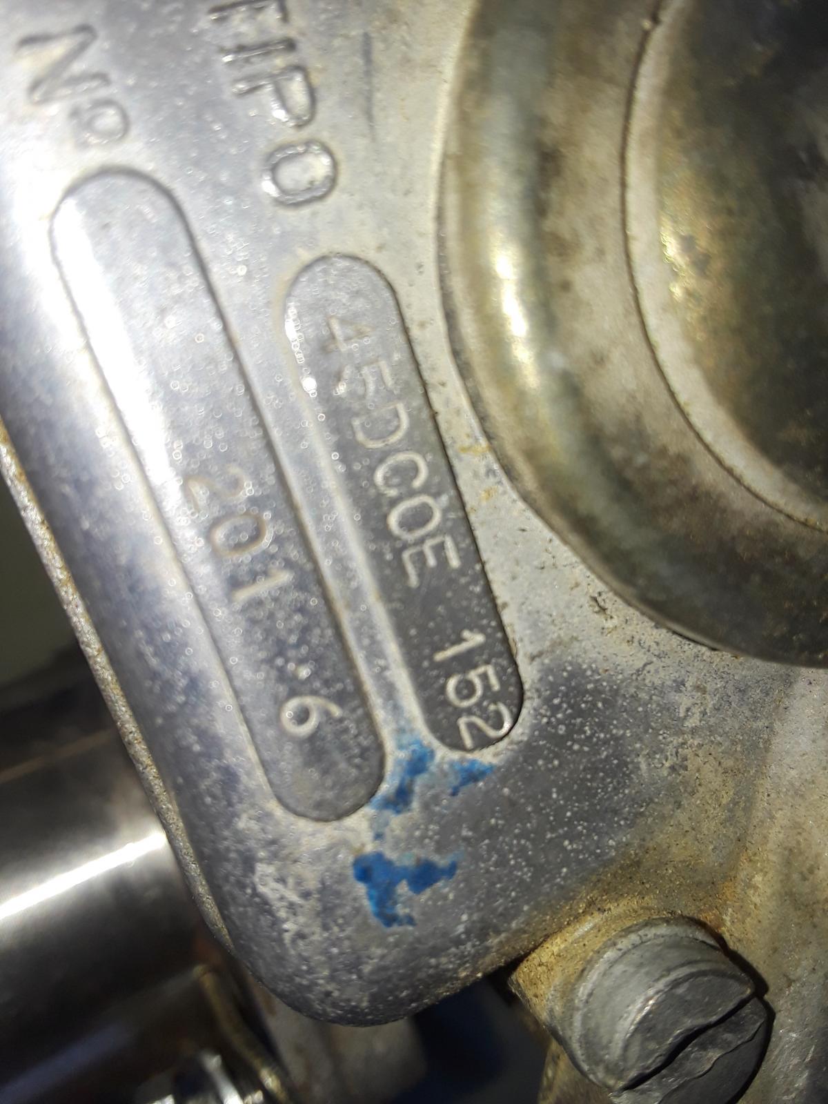

I was hoping you'd chime in! The package came with a 45 DCOE and I'm hoping to use that, until/unless it's completely unusable, in which case I'll roll over to a Holley 4 bbl

44 HPMX Draw through 45 DCOE going in w/turbo
