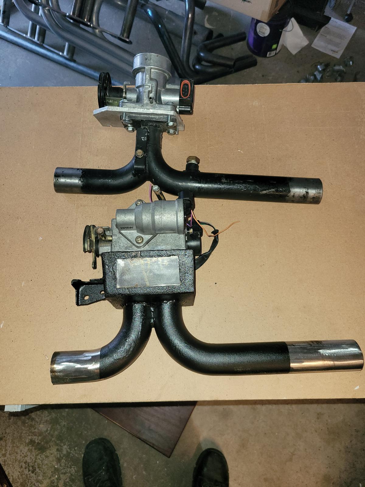

As those of you who follow me in these forums know, I love using OEM parts (VW or otherwise) on my EFI-Turbo Bug. I've been rocking a TB from a 91-95 Ford Escort 1.9L mounted to a custom make intake. I recently got my hands on a TB from a 2004 Mazda Miata 1.8L. Not only is the Mazda TB larger, it gave me chance to rethink the intake manifold. The Ford version consist of a 1-5/8" center cention splitting off to two 1-5/8" runners. (see picture). The Mazda version has the 1-5/8" runners sharing a common plenum (something the Ford version lacked). I haven't done any dyno pulls or data lags yet, but they are in route.
Enjoy...

My issue is power before boost comes in... or the fact that the turbo takes FOREVER to spool up. Im hoping that a better flowing intake plus the soon to come larger up-pipe (1-5/8" to 2") decreases the boost threshold. Im not after more peak HP (though would be nice) I'm looking for power to come in sooner in the RPMs.

How much larger is the new one? I had a 50mm on my 1600 and i could make 30+ psi of boost at like 50% throttle (maybe even less). Makes boost duty tuning challenging. Even on my 2054 that same 50mm will make full boost at somewhere around 65% throttle. I always thought a smaller tb might be better. I could be way wrong though. A smaller one could be a choke point higher in the rev range.

I'll have to measure them again, the numbers escape me at the moment. I took the car for a short drive today and it felt 1,000% more responsive. Perhaps its the TB or the larger volume on the intake manifold. The previous version had that poor engine breathing through a 1.635" pipe... now it its twice that! More solid data to come...
