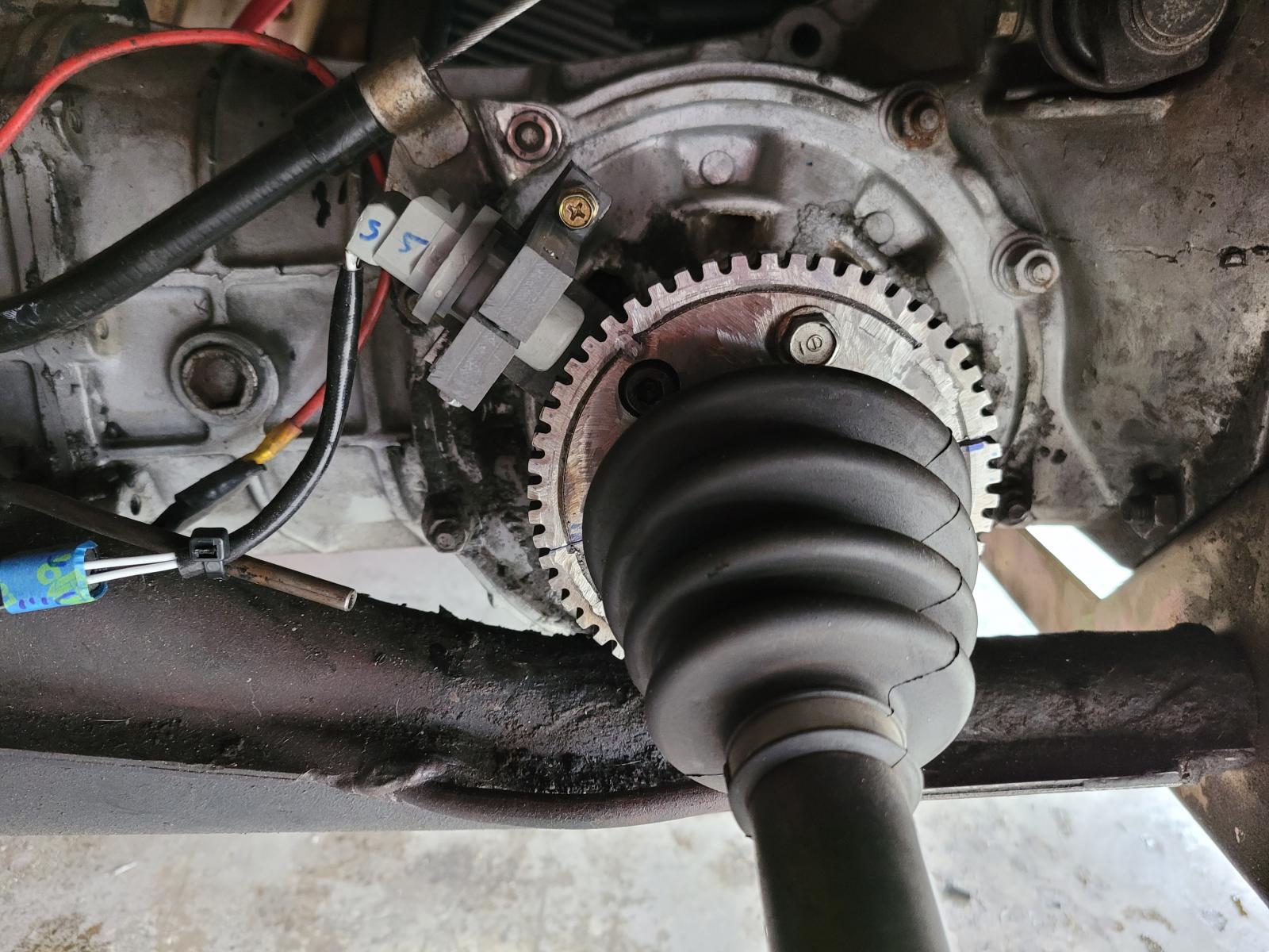

After much trial and error I finally got a semi-working (still buggy) Vehicle Speed Sensor (VSS) feeding my Megasquirt 2.
Here is the tone ring. The ring itself if from an unknown source. It has 54 teeth and is welded to a hand made hub. The wheel is mounted using two of the CV bolts (of which are longer to compensate for wheel thickness).
The sensor is from a 2000 Ford Powerstroke (7.3L) Cam position sensor. This sensor has three wires and produces a square-wave that increases frequency as the wheel spins faster.

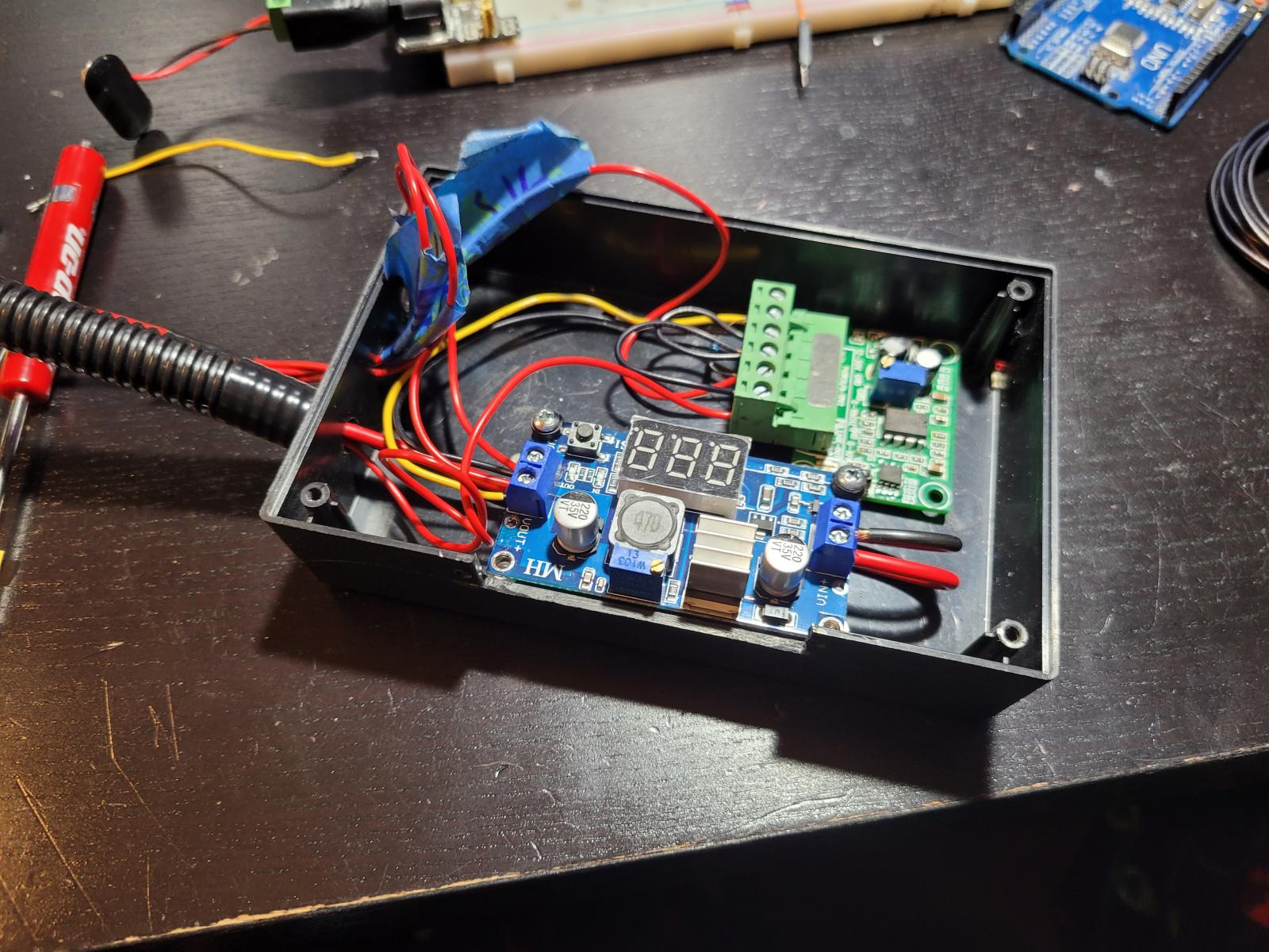

This is the "control module". The blue PCB is a voltage regulator (overkill for this project) that produces 5V. The green PCB is a Frequency->Voltage module. It takes the square wave from the wheel sensor and converts it a linear 0-5V that the Megasquirt can use.
On the MS2 itself, I am using ADC6 as a spare input. The only issue I have right now is the fact that Amazon sent me the wrong F->V module (0-10KHz) so the resolution from the sensor is rather poor. I have a 0-3Khz module in route so this should improve the VSS output.

I got pretty good speed resolution on mine with only the 5 axel bolts. I would imagine the tone ring will work more better.

I was using the CV bolts in my first design, and it worked well at medium to high speeds but was twitchy at lower speeds. I wanted something with higher resolution. 90% of my "ideas" are stolen from modern OEM setups. The hard part is getting them to work on a 50+ year old car.

Any before shots of the ring adapter?

Sorry, no pictures of the tone ring / hub. I kind of made it up as I went.

So I finally had a chance to test drive the car with the VSS setup and the new Frequency to Voltage converter (0-3KHz). I had my GPS running at the same time for verification and the VSS was impressively close. Maybe 2-3 mph off from what the GPS was showing. My only gripe is that the read out on the dash is a bit twitchy as the MS is receiving a raw input, no filtering or buffering, but I can live with it. Perhaps one day my arduino skills will be enough to create a signal conditioner.
