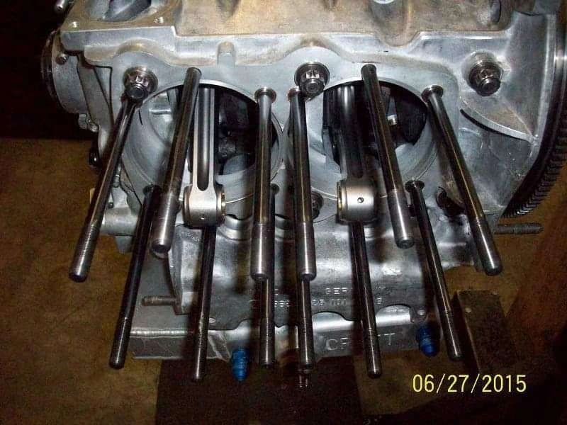

A little history on the engine...
Started with a 2.1L case and did LOTS of modifications at Rocky's...
Machined off water jackets, relocated head studs .050" from center, added 4 more head studs, bored for oversized cylinders (102.4mm)...

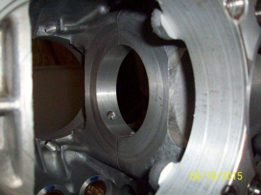

We line bored the center main to utilize a Ford bearing (2.75" journal size)...

Ford main bearing on left, stock wasser boxer bearing on right...

10mm head studs are made from Kryptonite! (As are the thru bolts.) :lol: Carrillo rods are 5.7" long, 3/8" bolts, and custom ordered extra beefy for high powered application. Engine also has custom CP pistons with extra thick wrist pins and thick wall skirts...

There many, many more details on this one off build! As you can see by the dates on the pictures, this engine has been together for almost 5 years now! I've only split the case one time since then (to do a cam change) and all of the bearings looked fantastic! I'll tear it completely down again sometime this year, but oil filter inspection and oil pressure does not dictate any concerns.
