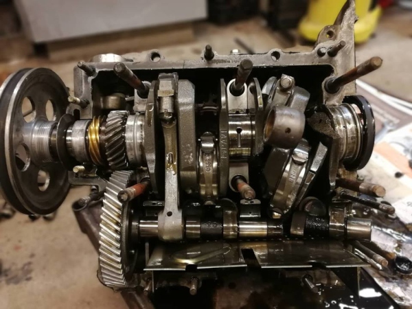

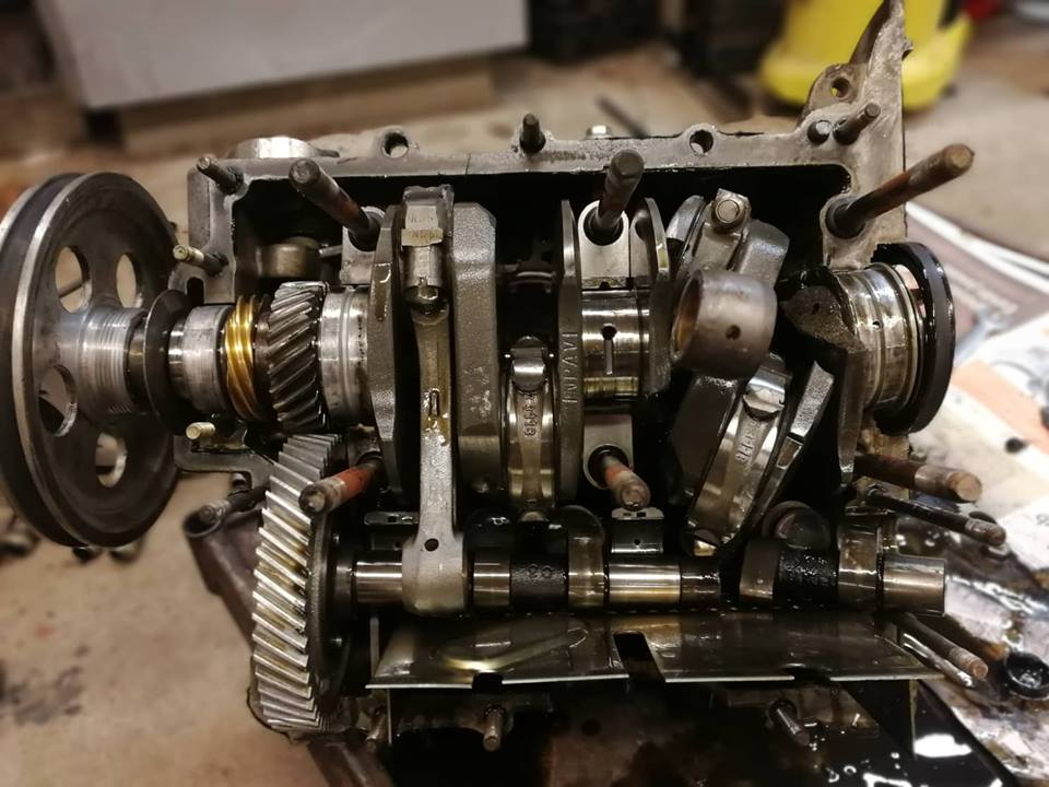

- V8Nate
- Posts: 840
- Joined: Mon Sep 03, 2018 12:34 pm
Re: Could anybody help me with putting together 78x90,5?
Now that's some carnage! Throw that oil restrictor plate in the garbage!

The standard CB Performance or Scat I-beam rods are fine for a street motor. You can get them with ARP rod bolts if you want a bit more 'insurance'. From the picture, it looks like he's running clearanced stock rods so they should drop right in. H-beams are a good upgrade, but not necessary and may require some additional case clearancing.
- Kafer_Mike
- Posts: 493
- Joined: Fri Oct 04, 2002 1:01 am
If that is what you are referring to as the "OK brazilian case", I would double-check those crank and rod bearing journals and flush out all the oil passages really well. Also, it appears there's a crack in the top of the case near the 2nd case stud.
