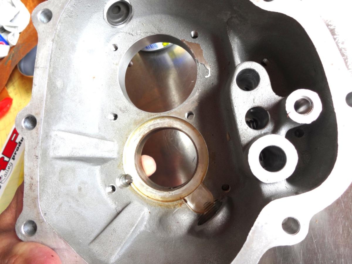

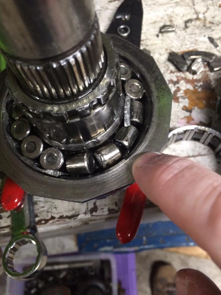

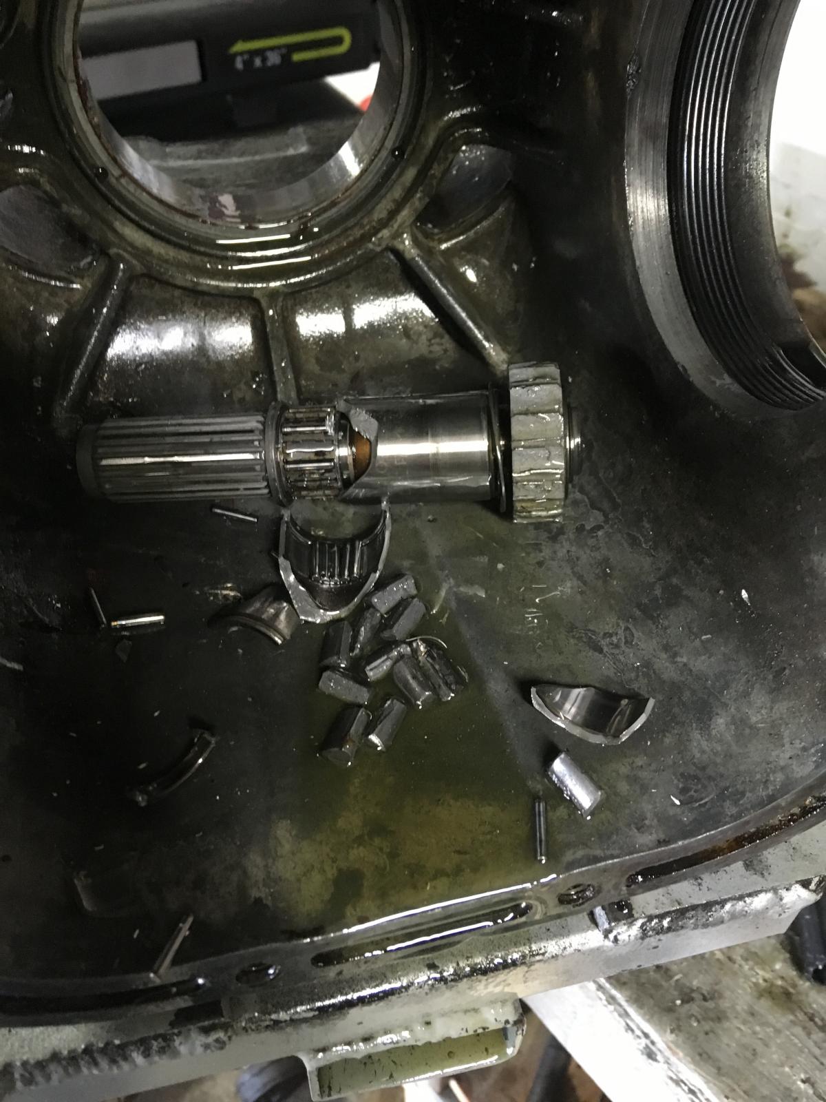

Here's the pinion bearing failure, he brought it in as reverse wasn't working. It had been making noise for a bit, but he was still driving it with the noise.

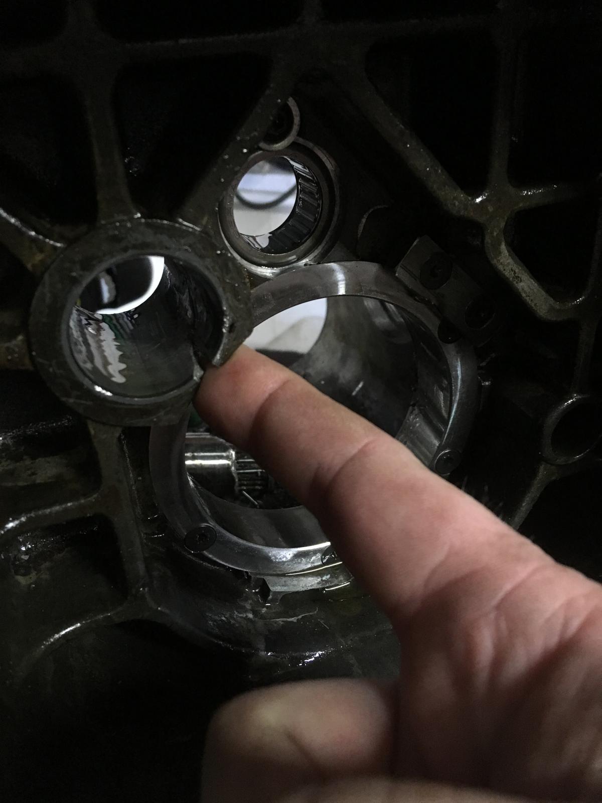

Here's the bad 091 reverse, ruined a steel sleeved case.

GREAT shots, Timmy. I can't say that I've ever seen such a dramatic failure of that bearing.
When VW changed to different sized rollers on either side and eliminated the thrust washer, problems began .. especially in off-road racing.
It's said that ultra slippery synthetic gear lubes can cause rollers to "skid" instead of roll. (I've seen this on the mainshaft needle bearing in later model waterboxers, due to their smaller diameter needles.)

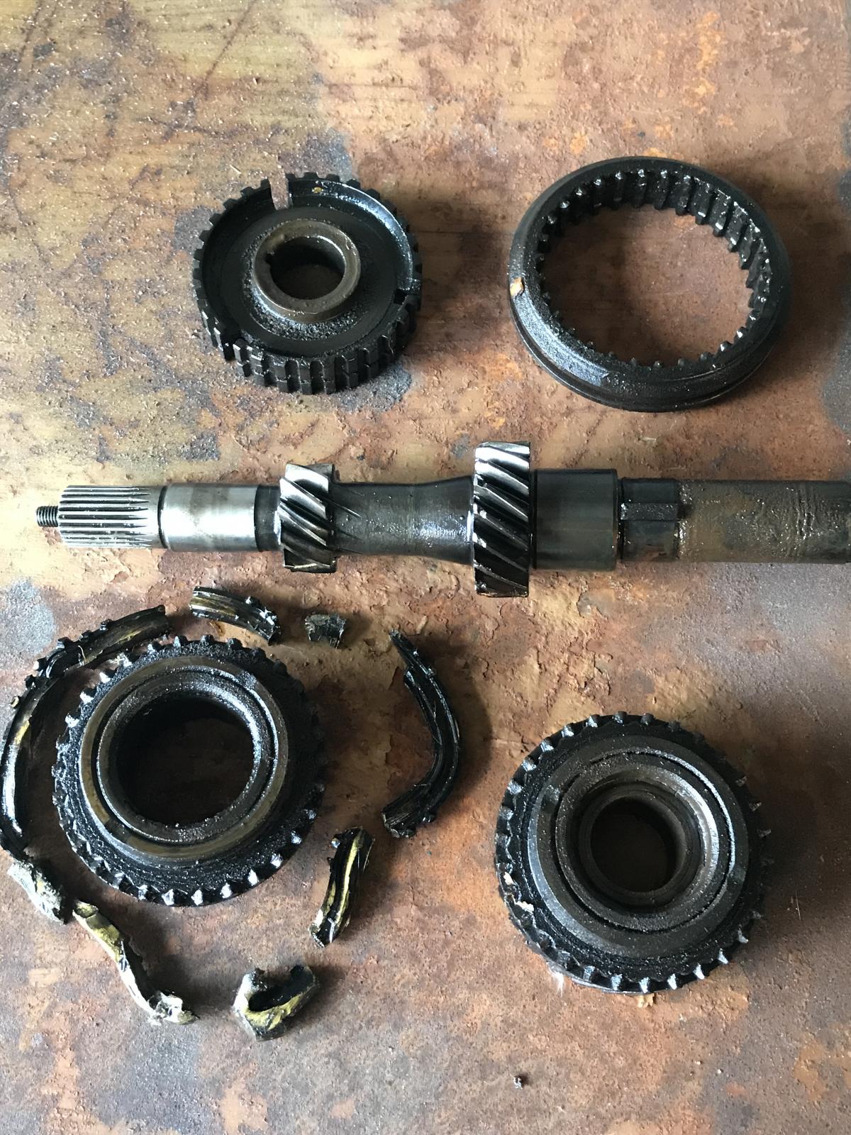

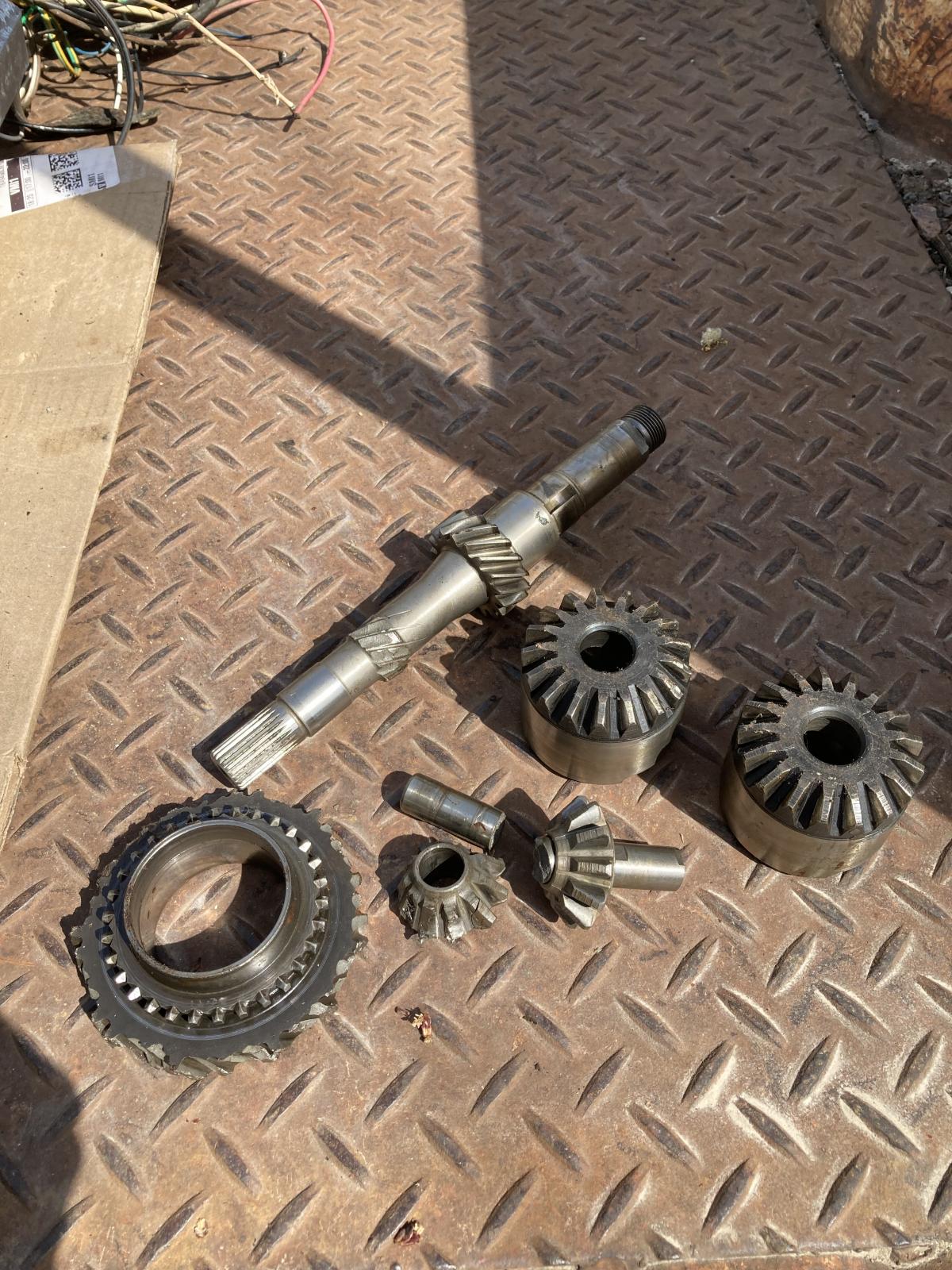

here are some pictures of the bits that came out of the core I described above.
3rd synchro exploded and made its way out of being trapped between the 3-4 hub and 3rd gear. 3-4 hub is somewhat dished on one side of the flat just out from the ID. slider didn't seem to have much damage but I'm still throwing it in the scrap bin. 2nd gear on mainshaft got chipped up pretty well. synchro cones on 3rd and 4th are both kinda chewed up (4th synchro ring was still in place.) one of the springs that hold the 3 little slider keys in place was in 2 pcs, but not pictured. teeth on 4th were kinda rolled over just on the other side of the synchro ring.

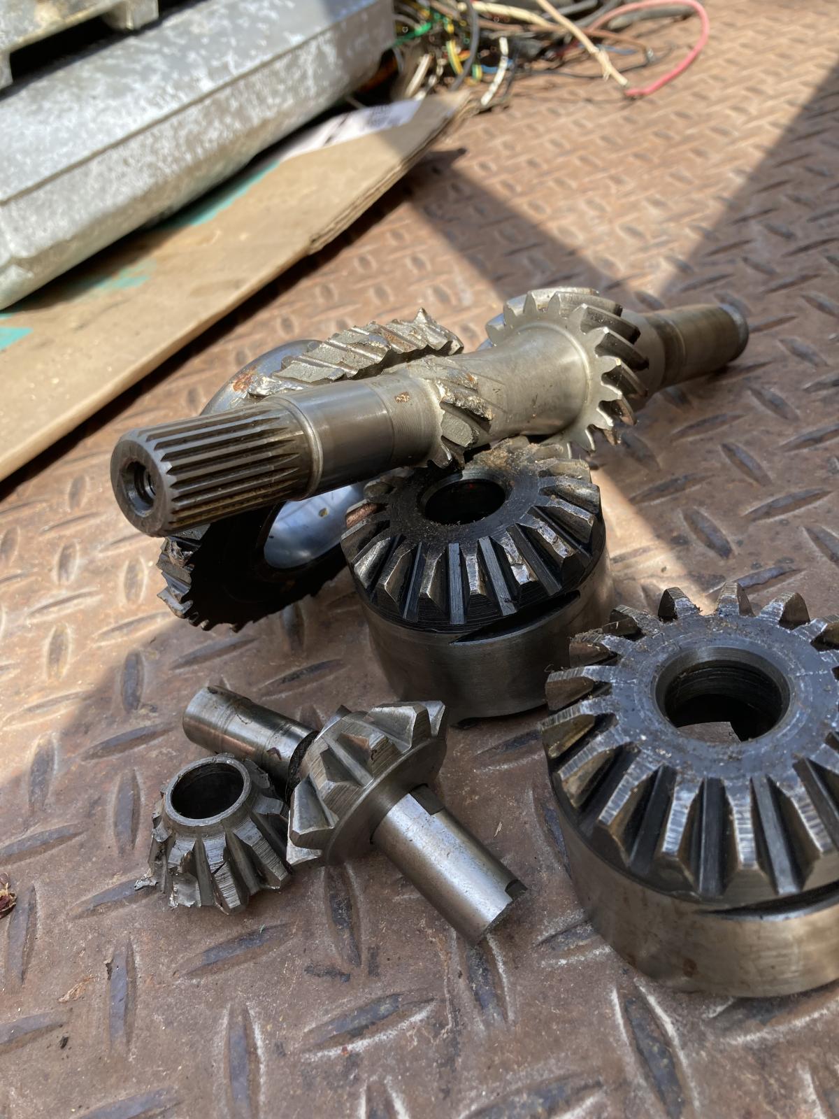

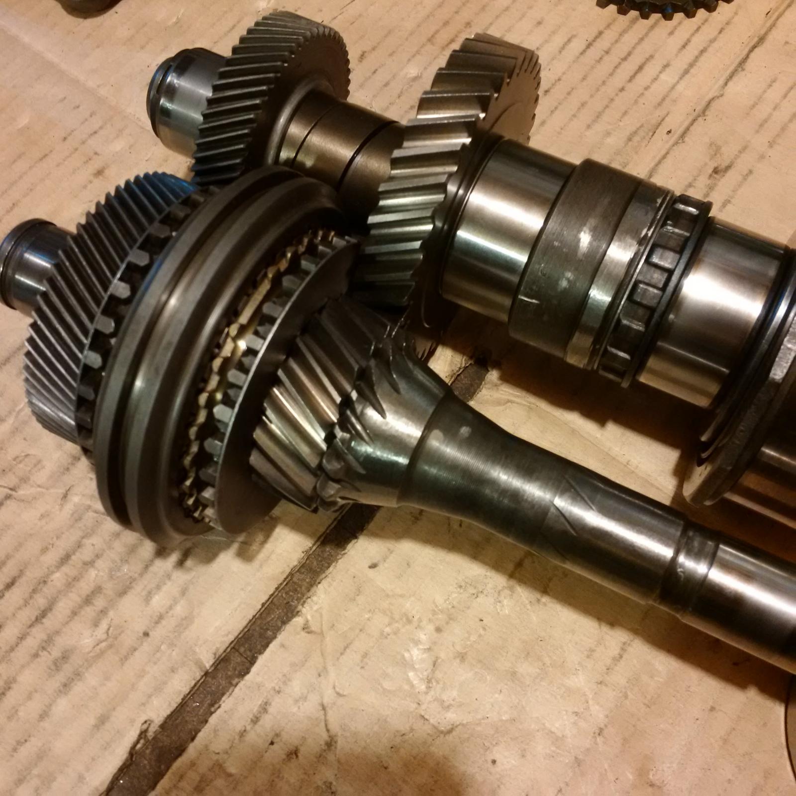

another fun one from a recent core tear down. I've never seen a more completely stripped 1st gear. 3 piece spider shaft also interesting. what came first, chicken or the egg?

nshaddox wrote: Wed May 31, 2023 11:15 am I've never seen a more completely stripped 1st gear.
I had a mainshaft like that, and re-used it!
Image This was for a custom 2 speed trans for an electric car.
One trans I took apart was full of busted parts. The reason it was taken out was for a stripped reverse gear. I suspect it was built with one of the notorious soft idler gears VW made.
But that wasn't all. Second gear synchro was broken into two pieces, but they stayed where they lived, unlike Neil's.
The 1-2 fork had the tip nearest the shift rod broken off like we've all seen many times, although this was on a factory steel fork!
