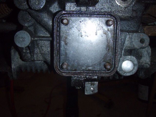

What do u mean by lower through bolt?
Its a AB CASE and lower right is a threaded hole but no others

Post by lil_azza »
Not my case but is the same il get the lugs tapped when i get the case cut

"AB" case stands a real good chance of being in great shape for its age (it's hard to damage a 1300, they don't make enough power to blow themselves up and usually just fade away).
The reason I asked about the bosses is that "pure" Beetle cases don't have any of them; sometimes only one case half has them, and you need to shorten them to allow for the thickness of the steel adapter bracket. The brackets are intended for cases with NO bosses, and support the engine by longer oil-pump studs (and a flat pump cover) as well as one of the m8 case bolts...a picture of one should make it clear: http://www2.cip1.com/v/vspfiles/photos/ ... 5036-2.jpg
The case pictured has all three of the bosses incorporated into its casting. If yours does too, no adapter required - just the drilling/tapping of the upper ones to m10x1.5 and the bottom one to 8x1.25. You may need to dress the end of one or more bosses with a file to get the "moustache bar" to sit comfortably against the case, but the bosses in the picture appear to have already been hit with the mill at the factory.
These holes are usually found HeliCoiled for Bus applications, but there's really no need IMO to go to that much trouble for bolts that shouldn't be removed/reinstalled frequently..."raw" threads should suffice (you can always HeliCoil them if they ever do need repair).

Thats ok then, it came out of a mates bug
Yea my case is like that but shouldnt beva problem either way need to hurry n strip it all down so i can order bearings whilst its being cut
