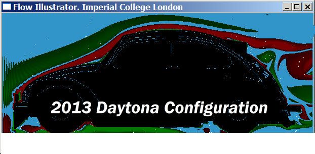

VW Bugs have a high drag area from the rear window on down. The air flow behind the Bug is actually trying to blow against the rear end. Above is the aerodynamics of our SuperBug as we last ran it at Daytona, clocking 125 MPH on the banks. That's great for a Bug, but not good enough for Daytona.
Exhaust heat gets picked up and depending on your road speed, "pocket" inside the bumper or under the sheet metal just above the bumper. Obviously, this isn't common. That's why I said something is different after your engine rebuild. Possibly you just might have a new muffler "burning in."
Muffler heat pocketing was bad enough in the 356 Porsche that new, the cars came with a sheet metal heat shield plate over the oil pump cover. Careless mechanics tossed them over the years, and many 356's ran high oil temps -- the owners never knowing why.
FJC
