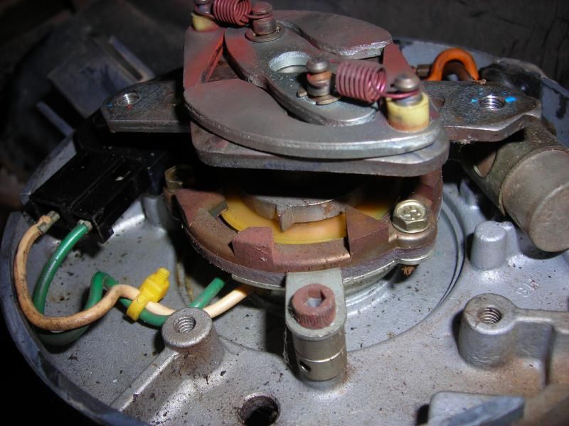

Well, After removing carbs, they are 44IDF's, not 48IDA's. Kind of a let down. He built this motor so long ago, he had forgotten this detail.
I'm still going to get some pics of the dizzy up, just not sure if you want to see it in 17yrs of dust/dirt. It'll be a little while before I can drop the motor and get it on the stand. Still need to make room for it(motor) in the garage. Too damn much water cooled stuff and other junk.
- squeakie
- Posts: 103
- Joined: Thu May 08, 2014 8:51 am
Re: Why no HEI ignitions?
Yes, of course we want to see it!
No vacuum advance huh ??? And double o rings , smart.
Dual carbs, so vacuum could be limited, but with IDF's there could be a port for it. My father built this particular motor about 20yrs ago, and has been building/working on ACVW's since the late 60's early70's. And from what he tells me, this motor would pull from low rpm's in 3rd/4th gear in town and rip over 7k rpm when asked to. So, the adv curve must be good for it. I plan on getting it running in current trim and then going from there. I have been reading/learning what I can on the ACVW forums, and from what I gather, there is not much I will need to change, if any at all. Motor-wise or suspension-wise, he knew all the good tips and tricks and the interior is/was perfect(just needs to be rehabbed).Jaxdream wrote:No vacuum advance huh ??? And double o rings , smart.
