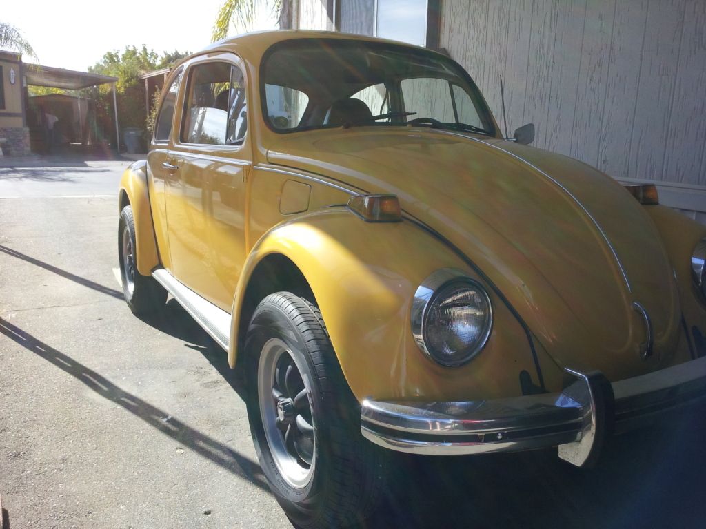

http://i1178.photobucket.com/albums/x37 ... 160618.jpg (1973 standard)

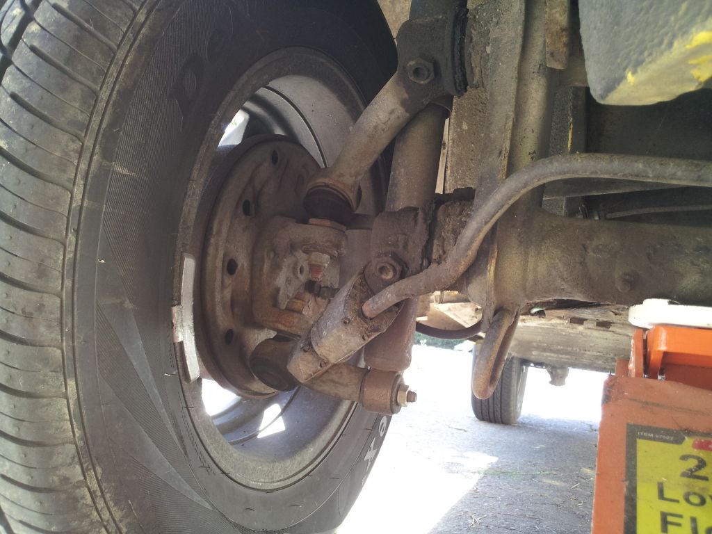

Well i got to poking around, all rod ends are sloppy, ride height ball joint angle is high. I always figured it was lifted....

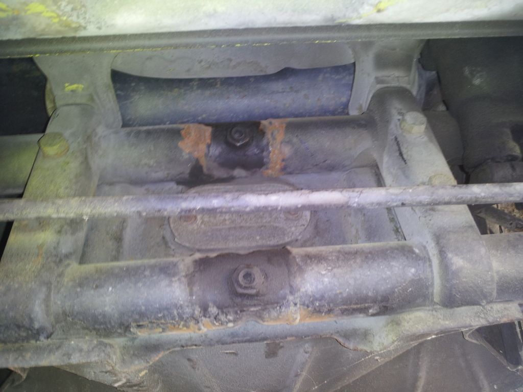

Does this look like that weld in adjusters that was popular in the late 70's??
Are they also used as "spacers" to push out the tires??
These welds arent the best either. And they didnt even bother to spray paint the finish. I havent determined rust quite yet.
Im getting nervous.. Needs a transmission and front end... Here we go.

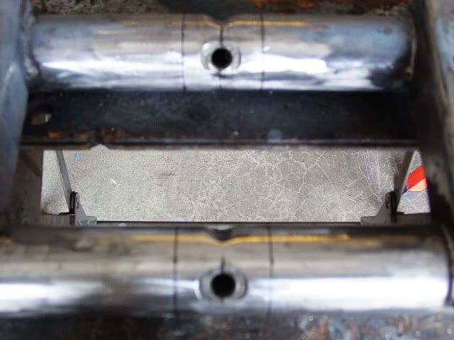

http://www.mooreparts.com/store/product/1107/AC401102/
This is what an Avis adjuster for a king and link pin beam, for a ball-joint beam it looks similar.
A sway-a-way style of adjuster looks like as it is being installed in a beam.
This is what the area where the grub screw and lock nut would normally sit in a un-modified beam (this happens to be a ball-joint beam.

That looks like a "not adjustable" front end, as in they decided how much to go and welded the centers in place.
Not a bad way of doing things, some say it is more bomb proof than adjusters, but I am far too indecisive to select a ride height once (or resist the urge to make a 1/4 inch adjustment).

Nope, that's the Sway-a-Way type.Ol'fogasaurus wrote:...A sway-a-way style of adjuster looks like as it is being installed in a beam.
"AVIS"
"Sway-a-Way"
Old-school "Select-a-Drop" (horrid concept, poorly implemented - camber isn't controlled and only the upper torsion stack is unloaded, so the lower stack ends up carrying most of the weight. I call 'em "Select-a-Flop")
There's nothing wrong with a "cut-and-turned" front end where the center section is rotated slightly and welded back in, provided you don't get too ambitious with it. Around ¼" is conservative and safe; IMO you're pushing things at 3/8", about the furthest most folks go for a balljoint baja beam.
