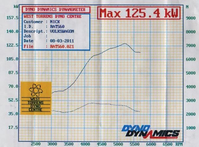

Hi all,I need some input on selecting a swingaxle trans combo for my Oval.Engine wise its a 2718cc type 4 making 172rwhp@5200rpm and 206 ft lbs @4300rpm.Tyres are 205/65/15 giving a height of 25.4inchs.The car is a weekend toy only,built more for scaring V8s than cruising down the freeway.I want to be able to stand on it within reason without anything braking so the questions are-
