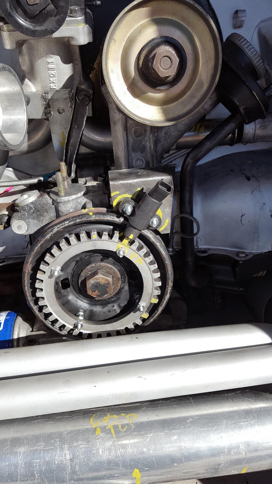

Here is my VR mount.
It is 10 degrees after TDC...or one tooth over.
I set the pulley for TDC and put the skipped tooth 90 degrees after the sensor.
Looking at my pic though... I might not have the toothed wheel set here yet.
After you set the wheel just start the engine without the computer on and just have power to the module and the coil.
Take a timing light and check to make sure that you are exactly at 10 degrees BTDC and you are good to go. If not... adjust your toothed wheel until you get the 10 degrees BTDC.
