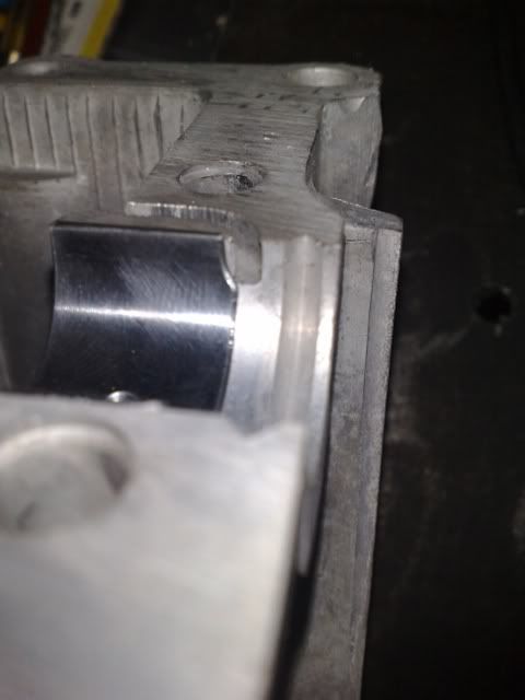

Just starting up this topic to share photos of my engine build and ask questions as I run into problems. This is a 2276 that is going to have a German EFI and megasquirt from Mario Velotta
and a turbo.
Here's a few pictures of the clearanced AS41 Brazilian magnesium case,
Cheers

Clearanced the cam bearing for the oil galley
From this
to this
