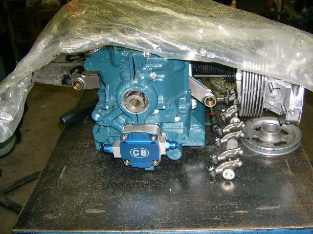

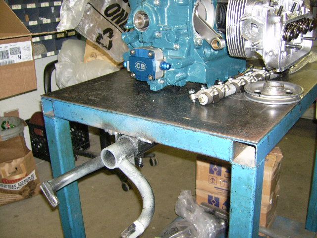

I build engines off a table with a 1/2" plate bottom, very stable.
I short block them on the stand attached to the table.
Then I set them on top of the table to finish.
It's on casters so I can roll it out of the way when necessary.
