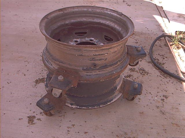

These are mine made from old rims and I bought a bucket full of all metal wheels that look like they were cut off old rolling car jacks and they stack easily ED
