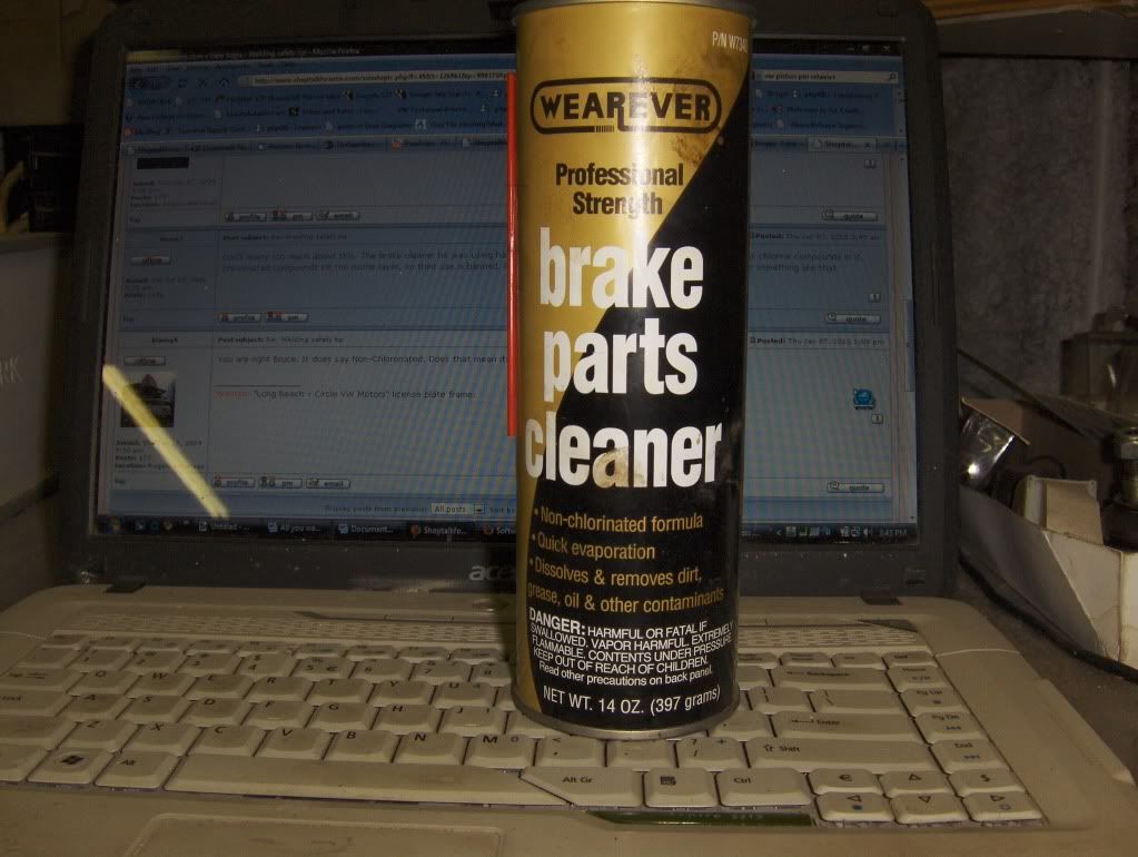

You are right Bruce. It does say Non-Chloronated. Does that mean its safe to clean a greasy/oily part with before welding?
Re: Welding safety tip
It says vapor harmful on the front of the can.

DannyK wrote: It does say Non-Chloronated. Does that mean its safe to clean a greasy/oily part with before welding?
Perfectly safe.
That's probably why so many guys have used brake-clean many times and not experienced the problems in the link above. What they're all using is non-chlorinated.
