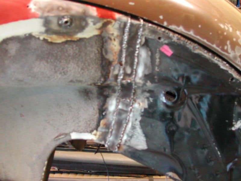

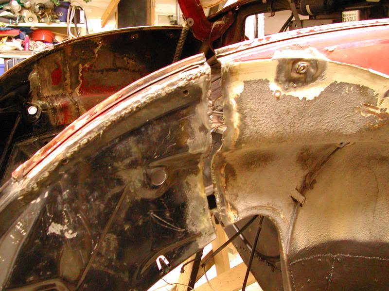

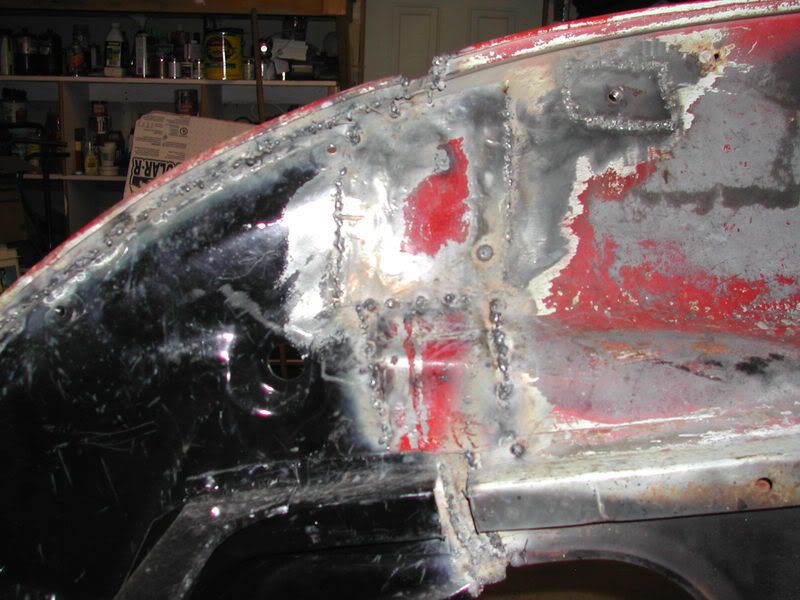

Hopefully these explain better than I was able. I use a grinder to cut the weld then put the fender on. With the fender on there was a 3/4 inch gap. From the inside I covered the gap with 3 inch wide welded patches, using leftover metal. Then went to the outside and welded a strip into the gap. Next I'll grind down the welds somewhat on the outside and cover with another patch. Then do the same for the left side.
I had replaced the luggage tray and am using the old one as donor metal for these patches.

View from the left side.
