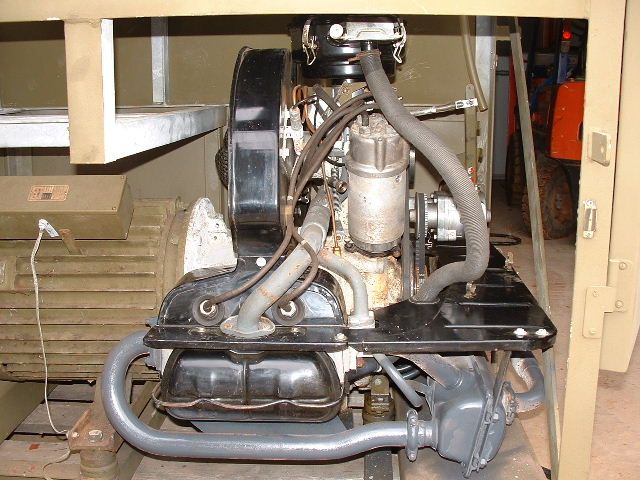

matara
Posts: 5
Joined: Wed Sep 01, 2004 11:52 pm
Post by matara »
There were plenty of the 126A Industrial engines used over here in Australia by the defence forces for a myriad of applications. Most were generators or 'gen sets' as they were known. Some were used for compressors, some for powering mobile cool rooms. There is one in its camo with cork particles on the tinwear to keep down noise. They came with Scintello magneto, and a governor. The 122 is a 1200, and the 126A was a 1600SP. I have three of these, one in my splitty, one as it was, and another I'm using the german crank in turbo project. Here are the pics:-
Cheers
Steve Moran
