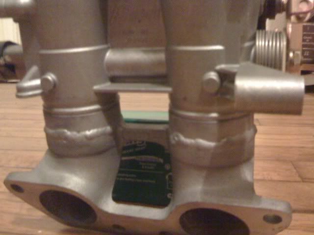

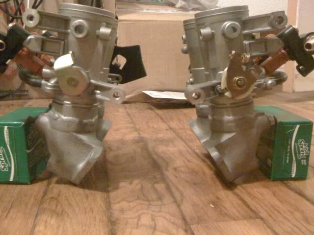

supaninja wrote:And of nowhere....BOOM! Some manifolds for my gixxer throttle bodies :)
Nice ones 8)
You allready measured the exact headroom for the Airfilters left?
Munch

I got exactly 3.5" left for filters. As far as cable linkage goes, I'll probably piece something together with bits from the gixxer throttle bodies and some cables from here http://www.pegasusautoracing.com/produc ... oduct=1270

Who made those? Those are rad dude!

My buddy eric anderson worked over some stock intake runners. They just happen to have the exact same center to center dimensions as 04-05 gixxer TB's. He's an animal when it comes to to precision machining.

I looked all over UNI's website and couldn't find the ones AC.net sells. I need to know the dimensions before I can pull the trigger. I'm going to try and sqeeze these bad boys on, http://shop.advanceautoparts.com/webapp ... %7CGRP2026_____
the only other 2 sizes that K&N makes are 4" tall(too tall), and 1.75"(too short, I don't think I'll be able to suck enough air through them). these guys are 3" which is just right, unfortunately they are for a 78mm center to center. I'm pretty sure I can use my man hands and make them work ;)

tomorrow I'm ordering some K&N filters and 1.75" couplers/clamps. All I need now is some slowtwitch cable linkage, does anybody know how to get ahold of him?
:shock: Sweeet setup! I'm such a newbie! That's why I come here often, there's so much to learn. Ninja, are the gixxer TB's welded to the manifold? if not, how are you mounting\attaching them to the manifold? I really enjoy the creativity and ideas on this site. I've gotten side tracked from my project for a few months now (home improvement project takes priority). Thanks.

I'm still waiting on the 1.75" silicone couplers/t-bolt clamps to arrive. I did get a hair up my ass the other day and added a throttle plate stop for WOT and a adjuster screw for syncing idle. I got fix my trans before I install the ITB's :(
