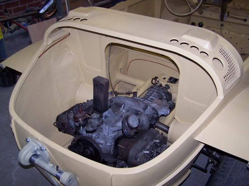

Put the engine in, start to build it up now.
Here with the tinware getting fitted in
Here shows where the air comes from. I think you will agree it is pretty unobstructed, and not near the warm air.

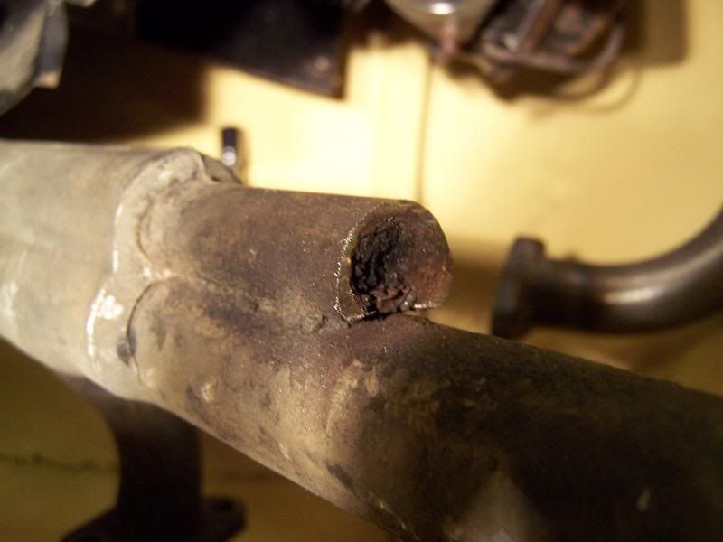

I figured on doing away with the warm inlet heater thingy. The pipe had rusted out, and when I see it had been blocked and not working for years I figured I could live without it a bit longer.

Clogged heat riser pipe is common. You're probably not going to use a stock exhaust system, so they won't be used anyway. Some guys try rigging them up to headers, but they really only work with a stock exhaust.

I dunno, i bet surfer (I can never remember whre to put the xs) set worked. That said, with an enclosed engine bay like that, as long as you have a good warm air intake I think it will run fine. how cold are you expecting to drive it in?

anything regularly below 60 w/ some humidity, the preheat makes a pretty soild difference, but that is in a open engine car WITH manifold heat, I don't know how much the enclosoure changes things. If he is running the stock air cleaner, warm air intake is no big deal. I think you need atleast one of the two, and if you are running over water that may make the need more obvious.

I don't know how Mr.Slug is going to finish off the engine bay, but since the fan intake is coming from outside the engine bay he could just leave it all open. The whole bay would be warm. A stock VW motor likes to blow hot air down to the ground, but on a amphibious vehicle that route would be blocked. The hot air will be push over the engine and then u-turn and head upward to escape. Soon after startup, this engine bay will always be warm.

I am finding this all a very useful education, and rely on you chaps to stop me doing anything to dumb. TBH, the car is just for fun - I cannot imagine that if it is really cold, I would want to be out and about. I also think the engine bay will be warm, for all the reasons already stated.
I guess I figure that as long as I introduce plenty of freash cold air throught the fan shroud and blow it over the cylinders - then the hot air will not only find, but be forced out by the incoming air.
