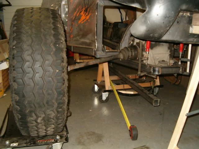

This morning I finaly found some time to work on "De Konjel"..........
Made the bracket to hold the front of the diff. and did some pre-assembly to see how it looks and if it all will fit.
Think it will be OK.
Now I can concentrate on the front suspension.

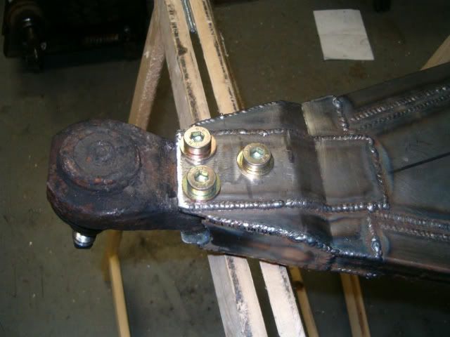

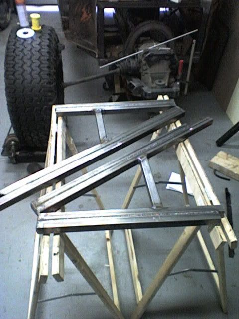

Started with the brackets for the frontsuspension.
bart

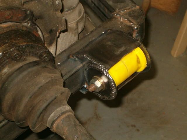

Dutch VeeRod
Posts: 287
Joined: Fri Jan 03, 2003 12:01 am
Post by Dutch VeeRod »
1 done :D ................7 to go :? :? :?

Hedrock
Posts: 3251
Post by Hedrock »
Nice weld'in :wink:
Hedrock wrote:Nice weld'in :wink:
hedrock, RLAP is the offical welding inspector around here :lol:
runslikeapenguin
Posts: 719
Joined: Tue Nov 07, 2006 7:42 pm
Post by runslikeapenguin »
dont you forget it. . . . .
Hedrock
Posts: 3251
Post by Hedrock »
Sorry... Hope I wasn't out of line :oops: .
runslikeapenguin
Posts: 719

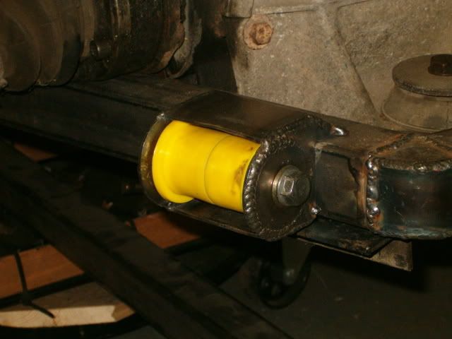

hey i just noticed something, those suspension mount point, are they going to be big enough? the bushing dosent leave much room for the pivot point to fit in there and travel, it looks like it would hit the upper and lower part of the bracket
Dutch VeeRod
Posts: 287
There should be enough room but I left it a little longer on purpose. :wink:
As soon as I have the sleeves that go around the bushings I can start with the arms. I want to leave as much metal on the bracket as possible. So as soon as that is ready I can grind out a nice curve and make enough room for the arm when traveling. :roll:
Bart

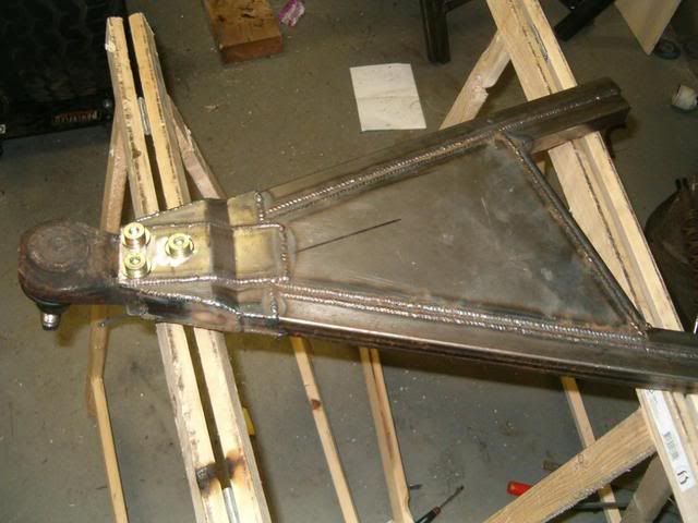

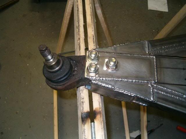

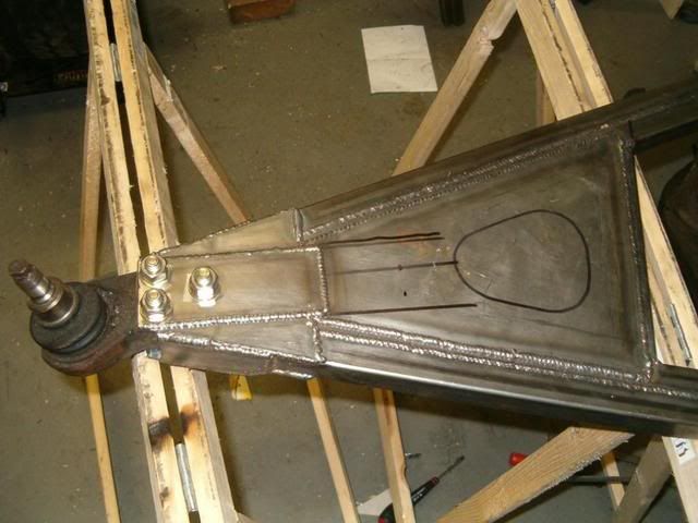

A little up-date.................
After a few weeks :oops: :oops: with a lot of other things to do that are more important (at least that is what my wife is telling me ............. :cry: :cry: :cry: ) did something on the car again !!!!!
Started with the lower front a-arms.

Friggen Awesome I wish I had a robot that could weld like that. :wink:
