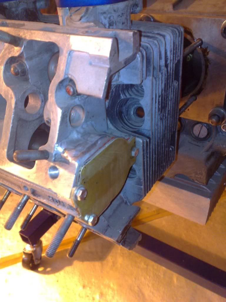

I know these pictures and my old engine is T1 but it is still to demonstrate the 911 conversion and the incredible strength achieved by adding steel plates on an engine block.
The same can be done to TIV, although I do not beleive it is needed for strength but rather if needed to combine with relocating the stud pattern.
Welded end of camhousing for the cambearing on right hand side. Not needed on left side.
http://i153.photobucket.com/albums/s207 ... ousing.jpg

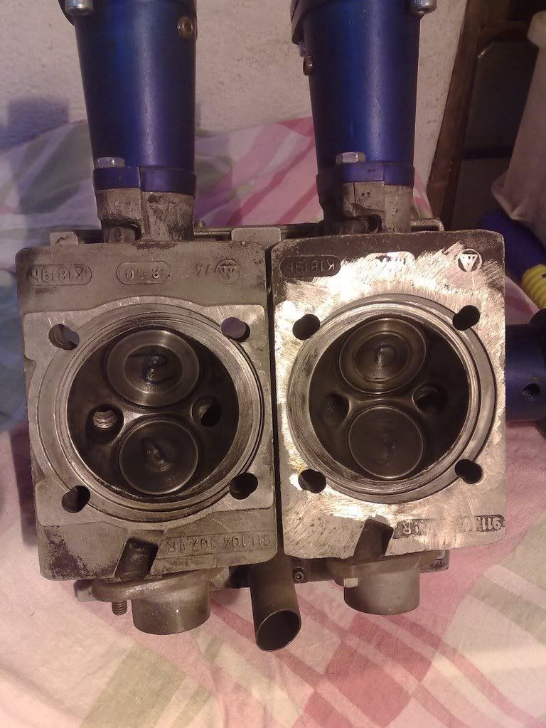

Here is a good view why I would not do this type of offset style. Just imagine how little meat I I have in the right hand side of the intake valve notch and the top ring.
http://i153.photobucket.com/albums/s207 ... piston.jpg
http://i153.photobucket.com/albums/s207 ... deview.jpg

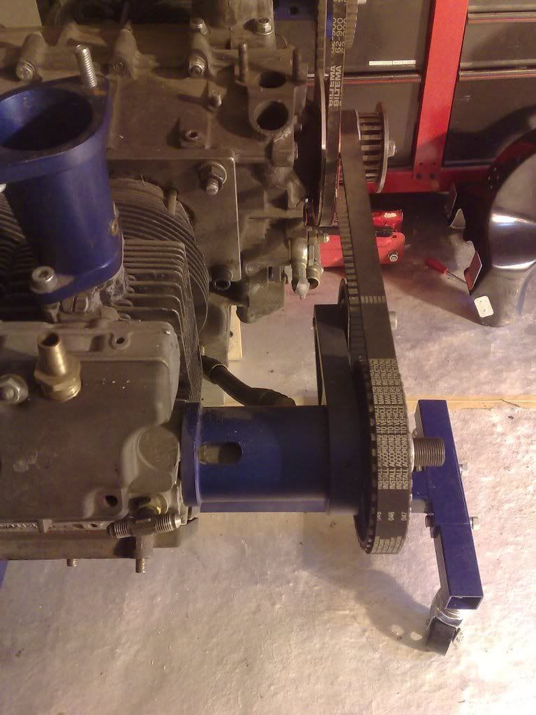

Here is good overview of the camhousing and also the oil hole for the camlobes is visible.
On my previous cams I did not hav ethe hollow cam but rather a spraybar above the cams.

You relocated the cylinders in the head spigot
That is an interesting way to overcome the difference in cylinder spacing I must say! No extra welding inside the 911 head done to be able to 'seat' the top of the cylinder on the side that moves inward to the head combustion chamber?
I also like the ring around the 'neck' of the Oettinger 90mm alu cylinder: for extra strength due to turbo use I suppose huh? Is it steel or alu? Looks like alu.
Very cool Frallan!
