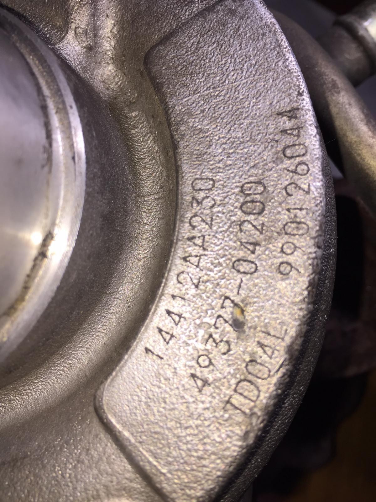

terryly wrote: Thu Feb 13, 2020 9:33 pm Subaru TD04L got it from a company that imports cars and engines from japan not sure what model it comes off. Our local Subie dealership says it is not in their data base for north American cars when I was trying to find a waste gate actuator that I seem to have misplaced and can't seem to find in all my piles of stuff :x So how do you think a 86a cam will work in a Turbo motor ?
I have a new actuator from my TD04. Not sure if it's the same as yours or not though.

Post by terryly »
WOW that would be just great bugguy how much do you want for it? I took mine off to reclock it. Hung the turbo and up pipe on the wall after a conceptual mock up for inspiration and a reminder of where I was going with the baja while I did a case swap with piston squirters, cam, rocker and behive spring changes to make this thing hold up better to a Turbo upgrade. Now I can't for the life of me remember what I did with it :x . There was also a major shop clean, paint and purge in the mean time and it may have gotten tossed by accident or just in a really really good safe keeping place :roll: I really need to to do an up date of my thread after the weekend on the turbo progress and not clutter up other very interesting threads viewtopic.php?f=3&t=150241 I will send you a private message.

No problem Terry. The guys here have always been there to help me and I will do the same. The actuator came on my turbo and I use an external gate. So its yours brother. I will send it out this weekend. Hope it fits!
