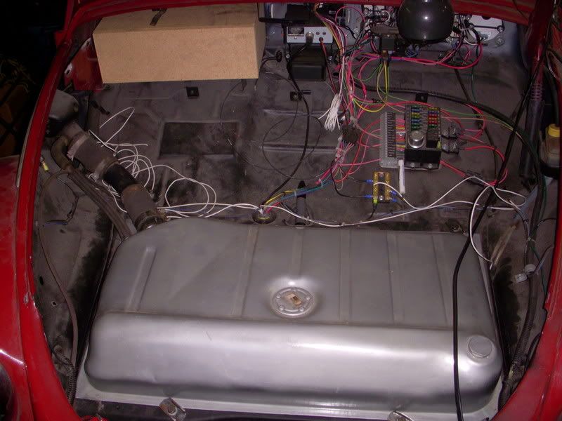

I installed the gas tank and started on my glovebox...

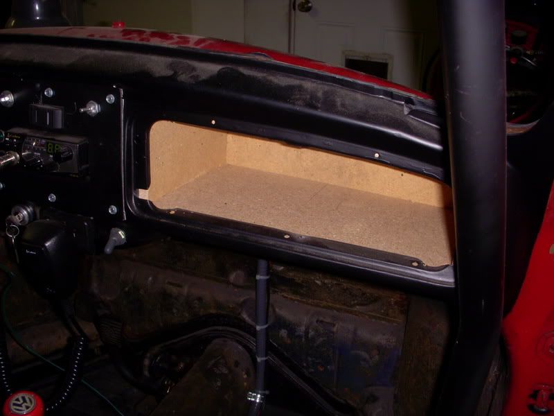

I plan to mount my radio inside it...and hopefully leave room for registration and insurance papers.
Can anybody think of a reason that this big of a box would be a bad idea? I hope to use the stock glovebox door, to keep people from getting too curious. I also plan to bolt the radio to the box....be hard as hell to steal.

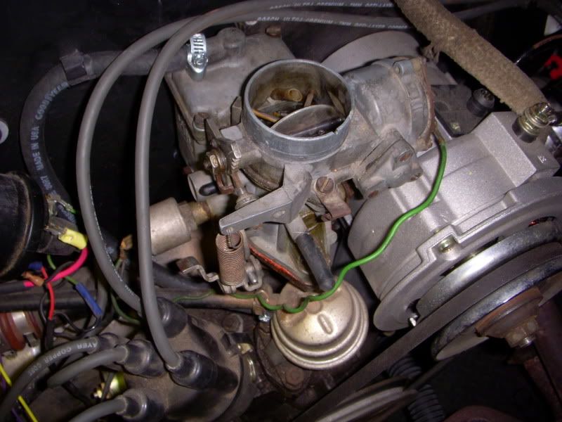

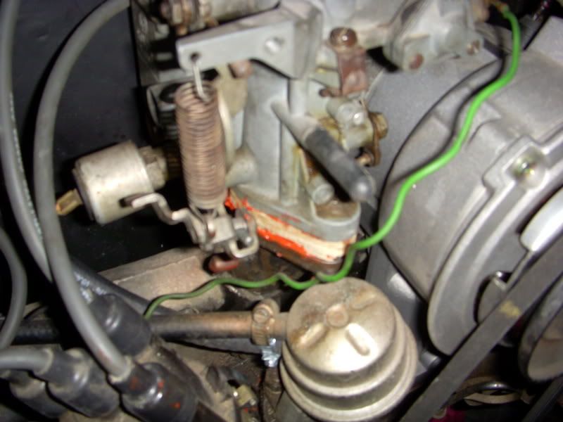

So I'm trying to get it running....
It will start, but won't idle. Is this the problem? I noticed the pumper? it's called in the book is jammed up against the alternator I installed. Is there a fix for this or do I need to get another carb? Mine is a 34-pict-3.
There was a thread here about this in the last month. The best thing would be a carb spacer to raise the carb up to clear the alt.
Jeff do you want it added to here? http://www.shoptalkforums.com/viewtopic.php?t=106599 (Off-Roaders rides) That way real easy to find, btw good to see progress. The only problem I see with the wooden box are fastners that will end up coming loose. Does look good though.

David58bug wrote:There was a thread here about this in the last month. The best thing would be a carb spacer to raise the carb up to clear the alt.
The only spacers I see are for 28-30 carbs.
Ricko mentioned rigid vinyl tubing for a homemade one.....any other options?
I don't want to grind the alternator....it's under warranty.

It is hard for me to tell how much the carb needs raised up to clear the alt. I am guessing about half an inch should do it.
Get out some wood and some glue. :lol:

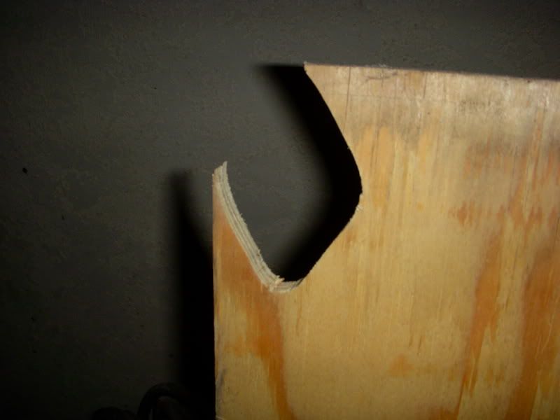

So...last night...took this:
Did this:

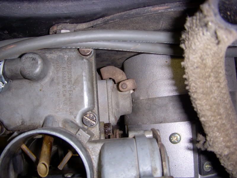

And gained clearance!
There's my temp solution!
I adjusted the flow 3 turns out and the idle 2 turns out and she started!!! :D
Now...I have to learn to adjust the 34....I saw a link somewhere...
My permanent solution is to cut my manifold from my old '67 engine and machine the mount. 8)
looks a little woody to me. :D :wink: :lol: It works enough to see thats all you need, for a 1.3479 hp increase :lol:
might make a supprt brace for under the stereo box, it might pop loose in the whoops...
and i dunno about that wood spacer :shock: i made one out of lexan once and after a year or so it was kinda soft when i took it off. if i was you, i'd cut your other manifold up quick.....
