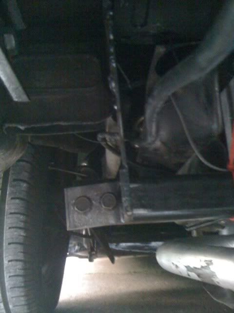

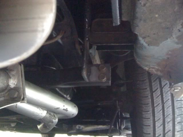

It's really tough to get under there and snap pics, too much motor in the way ;). I don't know how the other type 3's duct the cooling air but on notchbacks we have drain channels. Looking at it, theres a lot of bends and spot welds so I figured that would be the strongest point without reforcing everything. My buddy eric then welded some angle iron to some thick strap. He welded the strap all the way to the top of the drain channel. Of course I used a type 4 hanger bar and new rubber mounts. We preloaded it about 1mm too. The only movement is from the rubber motor and tranny mounts. There is a slight bit of vibration in the car now but it's no worst then the injected mounts in my honda.
Maybe piledriver can post up pics how he did his. he's using a t4 hanger with stock t3 mounts, my way only really works on a SA notch. It is a night and day difference, I'm haing so much fun now that I can safely get on it.

I took a pic of the rear mounts a few weeks ago when I upgraded to the late GM alternator, here's the center section with the Bus and added Vanagon outer mounts to prevent engine rock... These have metal stops, the most the motor can rock is ~6mm.
I thought I took a pic of the outer mounts, they are std late Bay Bus mounts for the crossbar, but trimmed down a few inches. They are welded on some ~2x4" rectangular stock to deal with the offset from the factory hanger locations, and the 2x4's are bolted directly to the hangers holes in the body.
