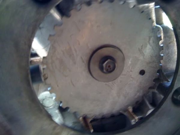

quick mockup of the motor, looks like a winner.
On a side note I'm going to have to get either a 411 or a 914 fan, or one of those bolt on timing plates for a bus. there is only one notch on my fan and its way too far to the left. Aside from that everything jives nicely. I'm going to drill and tap a couple of holes at 270deg on the back side of the shroud, then thread some button heads from the inside. I'll shim the sensor toward the block a couple of mm's. Its completely safe from the belt, and clears the motor bar and oil cooler too.

Re: T4 stock cooling--Crank trigger/CNP or COP using Megasquirt
You know... You can put the marks in yourself... and know for sure they are in the right place.
