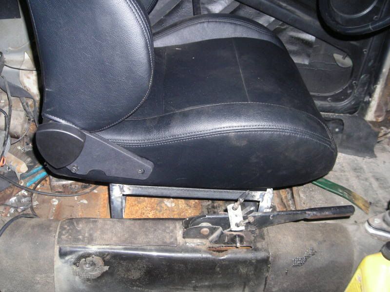

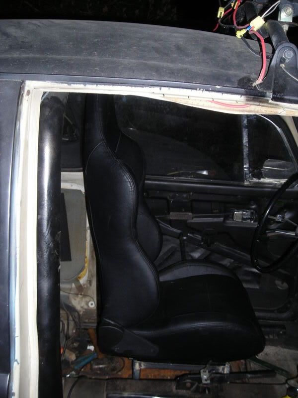

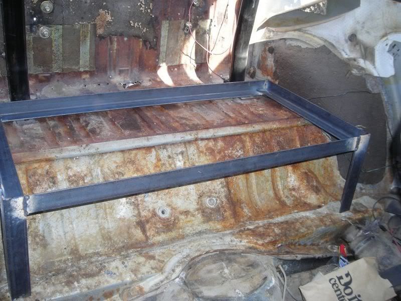

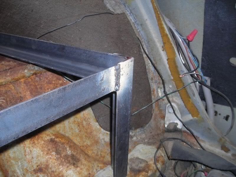

With that big of a fuel cell (22 gallon) It will cause a major change in handling when the fuel gets low. 1 gallon of gasoline weighs ~ 6.5 lbs. Thats 143 lbs of fuel full and will get less as i drive more.CopperBaja wrote:With putting on the one-piece front end, why are you mounting the fuel cell in the passenger compartment?
Just curious as to how you decided to go that route.
No, its a flux wire mig. Once I get some cash it will get upgraded for a full cage build. SomedayCopperBaja wrote:Ok...thanks. That definitely makes sense. Usually when you see a fuel cell on a baja with a one-piece front end, they usually mount them underneath.
Do you have shielding gas on your welder? Makes it alot easier for us that are new at welding.
I get what youre saying. But there are a few "rules" that go along with the fuel cell in the car. Obviously this is not a racer, most likely never will be. I dont plan on catching much air or doing anything extreme, but there is still a chance of a roll over. So this is how we remedy it.mike@crosbys wrote:i just get a little uneasy about fuel right behind me like that. I know chevy trucks among other things had the tank right behind the seat, but i dont jump and beat the poop outta those. I see a buncha people mount the cells in the car but it just makes me uneasy.

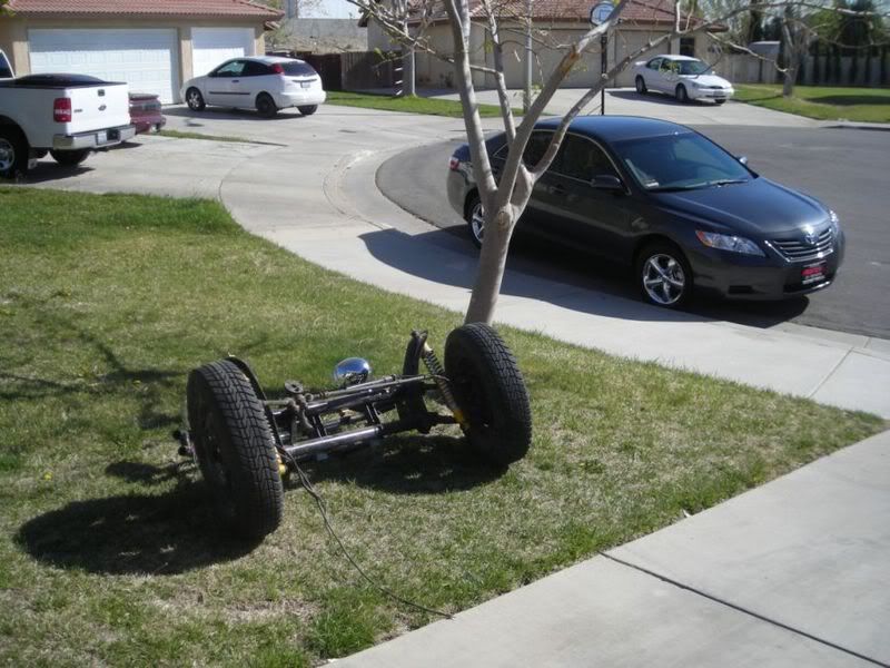

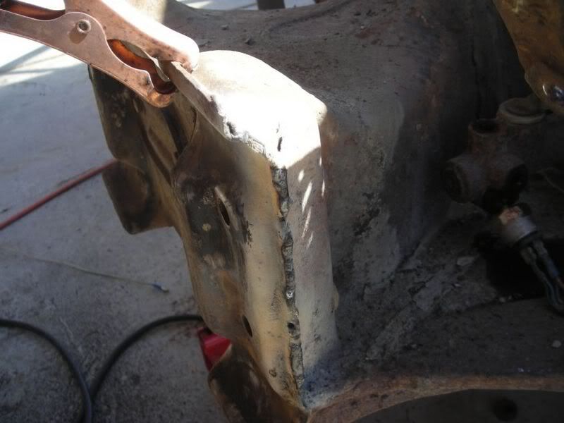

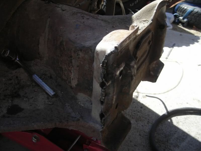

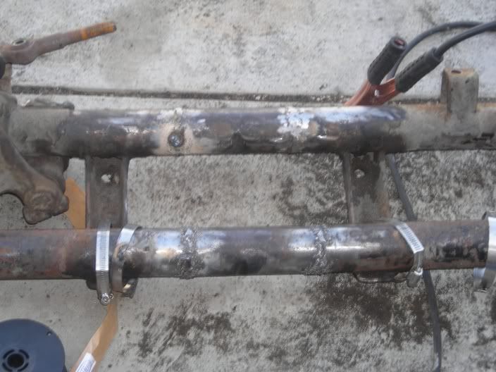

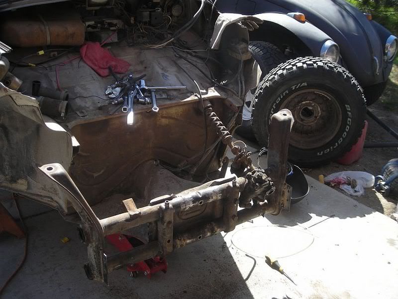

rickosuave1987 wrote:OK! I got my beam cut and turned today. I went 1/4". I didn't get it re-assembled yet. That will happen next weekend.
Dont mind the ugly welds...they will get ground down a bit
