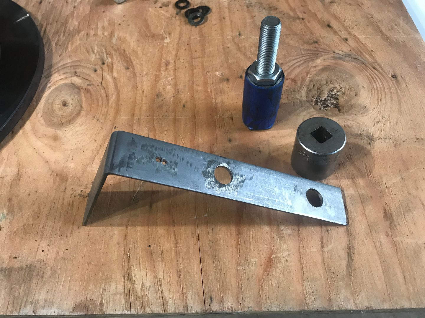

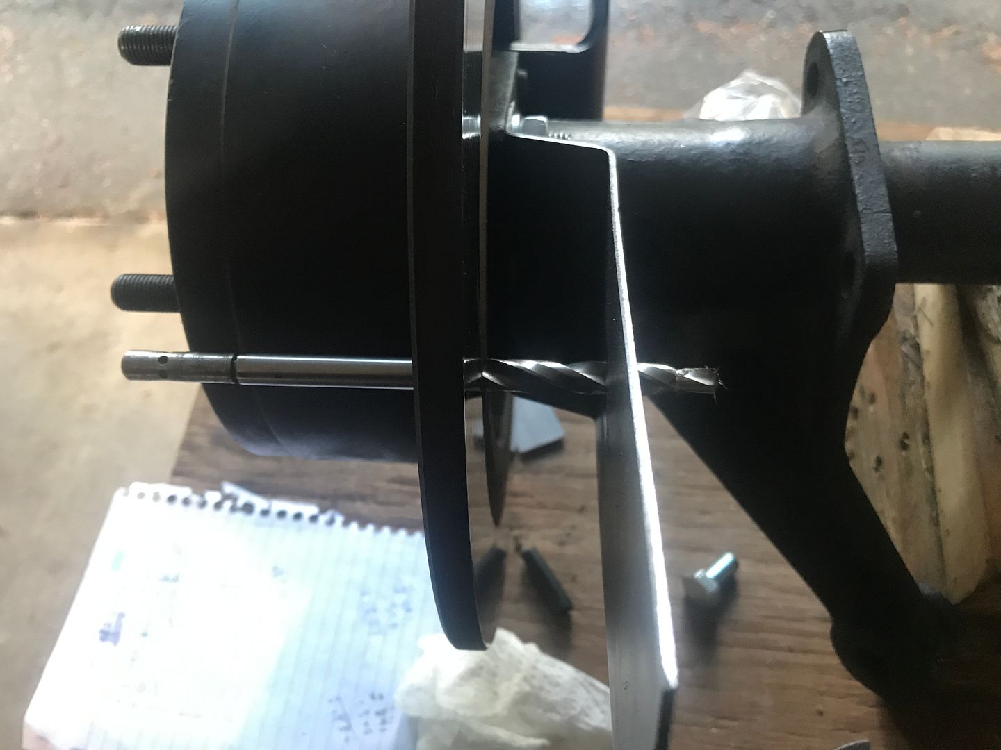

I made a simple jig off the wheel studs and axle hole using sockets and bolts and a piece of aluminum. I then used my drill press to drill the holes.
For the VSS mount I built a mount and used a hole in the rotor to drill through the mounting bracket.
I used a smaller drill bit for a pilot hole then drilled it out to I think it is 1/4 inch.

I can’t remember the exact size but they are 1/4 inch minimum and max of 5/16ths.
I think I used a Long drill bit I got from a swap meet guy selling surplus bits from Boeing or something… they are a stepped bit and worked well for the length clearance I needed on my drill press.

Speed sensor
