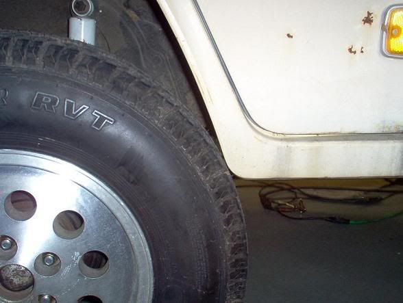

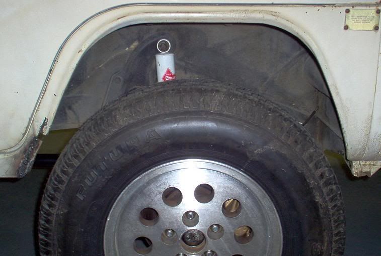

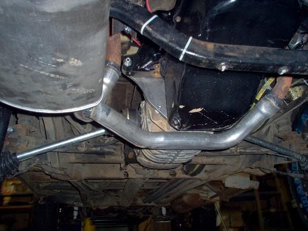

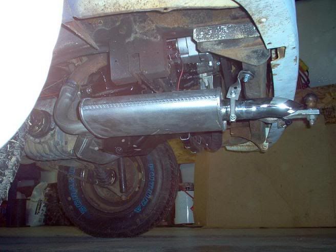

I finally finished the exhaust...... Now it purrs like a kitten...... It's quieter than my truck...('06 F-150).....It's not the purtiest but it's very strong and functional.........
Now that's done i have been working on a front tire clearance issue.... when I turn with 2 people in the front the tires slightly rub the front dogleg........ I decided to trim the front edge by 1" and blend it back into the fender contour..... Here is the problem and my solution...... I will be grinding and smoothing the sectioned portion of the fender....
Problem:
Solution:
More to come
Problem:
Solution:
More to come

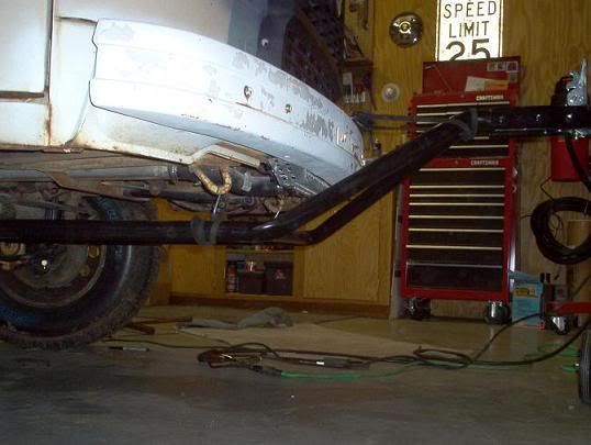

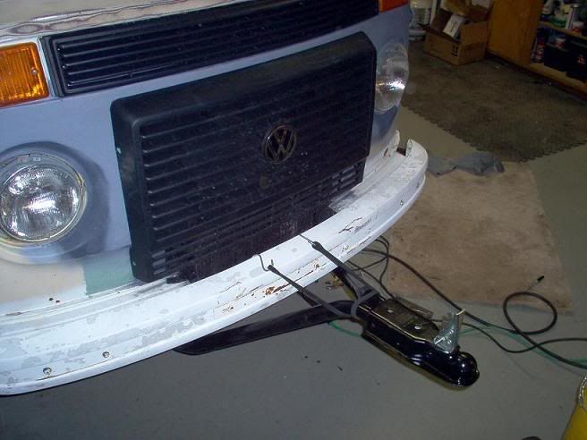

Also ..... My towbar came in...
....it fit's really well....... This will help when i take it to paint....... soon......

- fastmc25
- Posts: 290
- Joined: Fri Jan 04, 2002 12:01 am
Mounts to the front beam..... Just like the bug towbars...... Here is where i got it........
http://www.thesamba.com/vw/classifieds/ ... ?id=272546
I like it............ It sure will make moving the bus around town easier......
