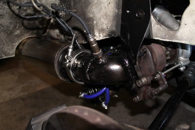

I am really interested in the way you have located your turbo next to the gearbox. So, would you mind my asking you some questions ?
How did you route the piping to the engine compartment ?
What thickness and diameter have you choosen for the exhaust piping ?
Have you tried to keep an equal length header ? Does it really matter ?

Hi Gatron,
Routing: don't know what piping you mean exactly, but most pictures are there I think?
Here you can see where the exit boost pipe from the turbo is pointing to: almost straight towards the intercooler and it goes just under the firewall into the engine compartment:
http://i174.photobucket.com/albums/w112 ... g002-1.jpg
Exhaust header is 38mm outer diameter (1-1/2" as the americans call it :lol: ), but its the only one I could easily find with slide tubing in stainless. 35mm would have been much better for 1200 cc and 35mm would also better fit the stock head exhaust port exit..
Yes, equal length IS better, but I could not make that in time for now. How much it makes a diference most nobody will be able to tell you, but read the JDM forums on high output headers and you'll start to see what the serious tuners do. Exhaust building is very time consuming and nobody makes a custom header in two versions just to test it out on the dyno and not change anything else.
I think keeping some length before the merge and NOT pairing 1-2 and 3-4 because its so convenient will help the most. Then, exact EL becomes less of a difference plus there is also something to be had in not making more bends then neccesary.
Just my perception on that subject, which is different then most on EL/non-EL I have noticed :wink:
BTW, I already seized up my main flywheel bearing after going over 5500 rpm for the first time :lol:
Engine is out and thinking how to get more oil into that d*amn first main bearing. I should have an old 40 horse bearing set with the oil grooves on the INSIDE like my type 4 has from the factory...
The normal for 'cross-drilled cranks' flywheel thrust bearing, even with my enhenced oil entry ports on the mains, just don't seem to cut it with the 21mm oil pump... I will change to 26mm, but still it could be better.
Maybe grooving the crank, but I'd rather have the right bearings with all the grooves on te right side.
