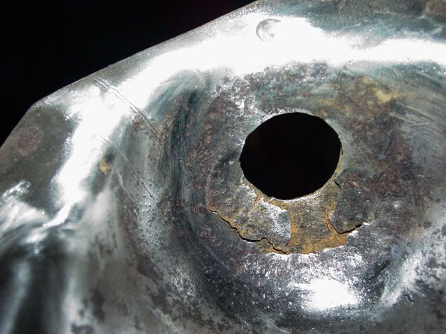

This is a photo of the area that was rusted out. I still don’t understand why only this bit was rusted while the rest of the tower was OK. The other side shock tower has no rust at all and neither did the beam. The only thing I can figure was the shock was on loose and it allowed moisture to get in there. This is also the original beam that came with the buggy which I bought in about ’93. It has been stored inside since. The guy I bought it from kept it inside also. The girl he got it from was a clown at birthday parties and drove it to them and it was kept inside also. Before that, I don’t know its history.

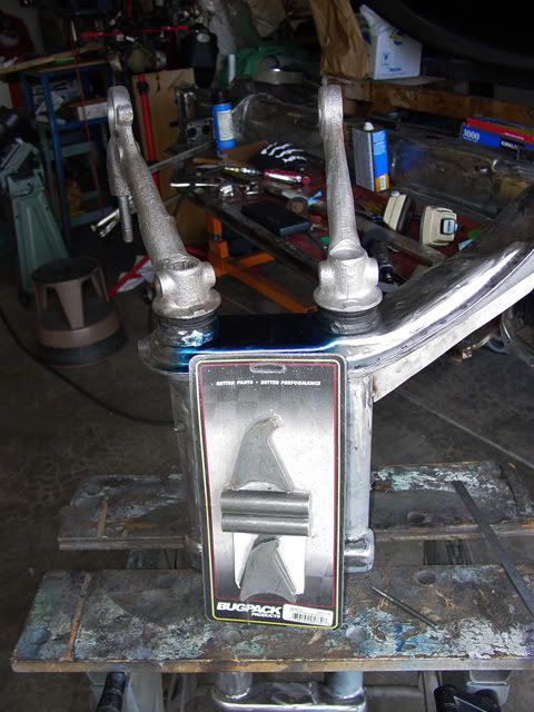

This is how I mount the beam so I can rotate it to get good working angles… when possible.
