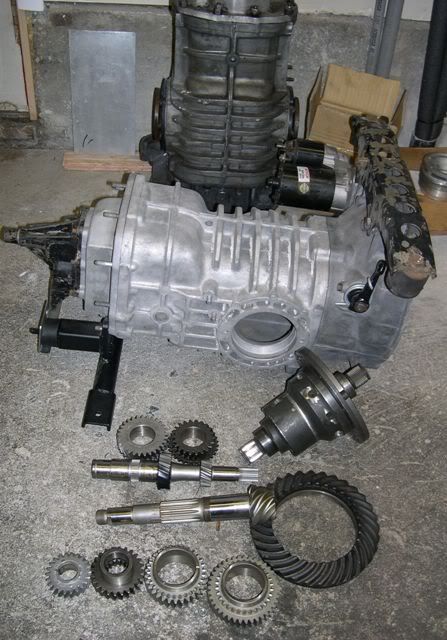

There is a Bus 002 ZF in this pile of bits. Its all destined for my notchback. In the near future I hope to have an 091 ZF sitting next to this 002 ZF to show the differences.
