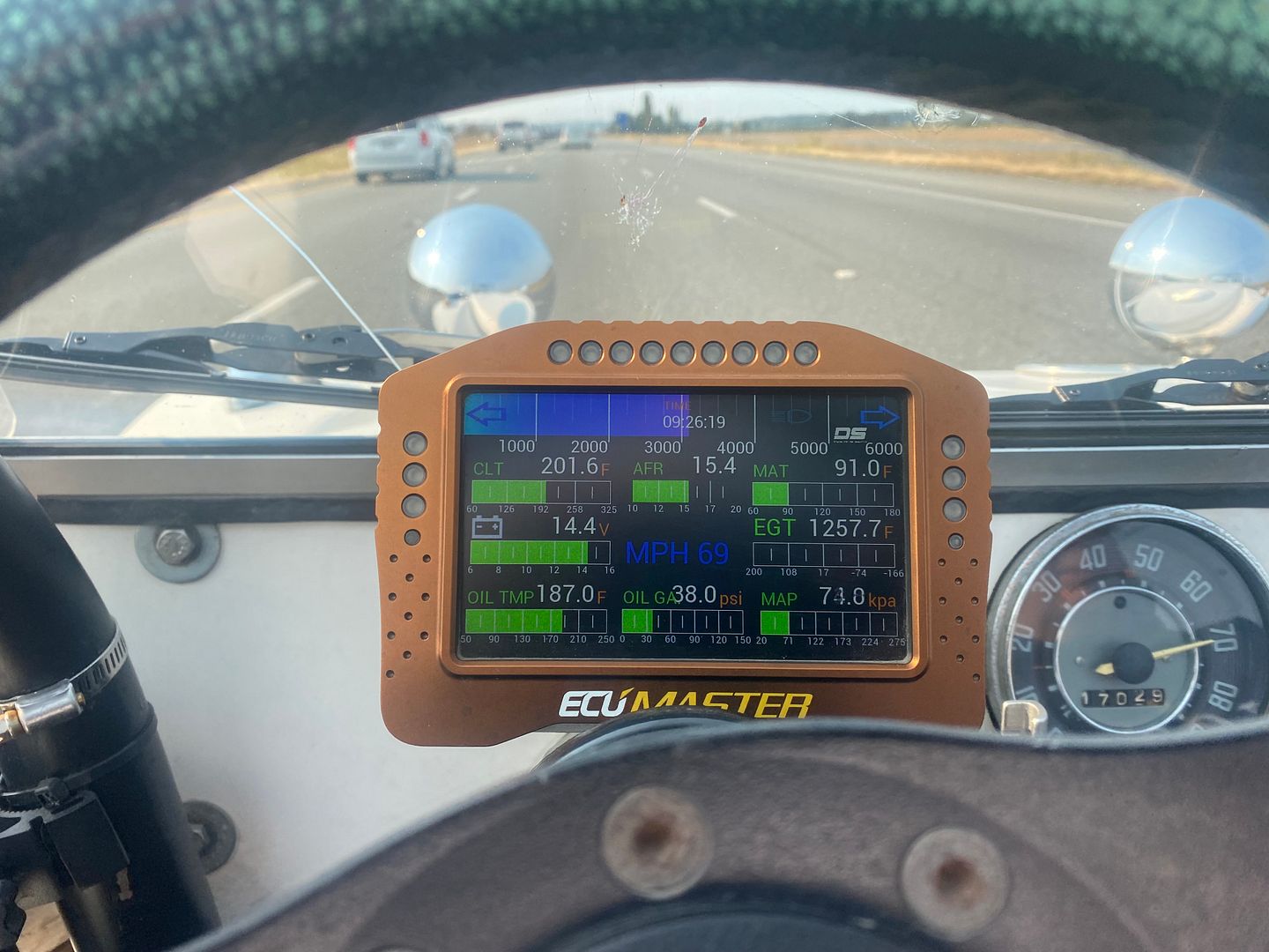

The buggy drove beautifully and cruised with no effort up the pass and everywhere. Here is a shot of the Digital dash while cruising the freeway.
This is a typical view of the dash while driving and the numbers are what I usually see while driving in the temps we were seeing.

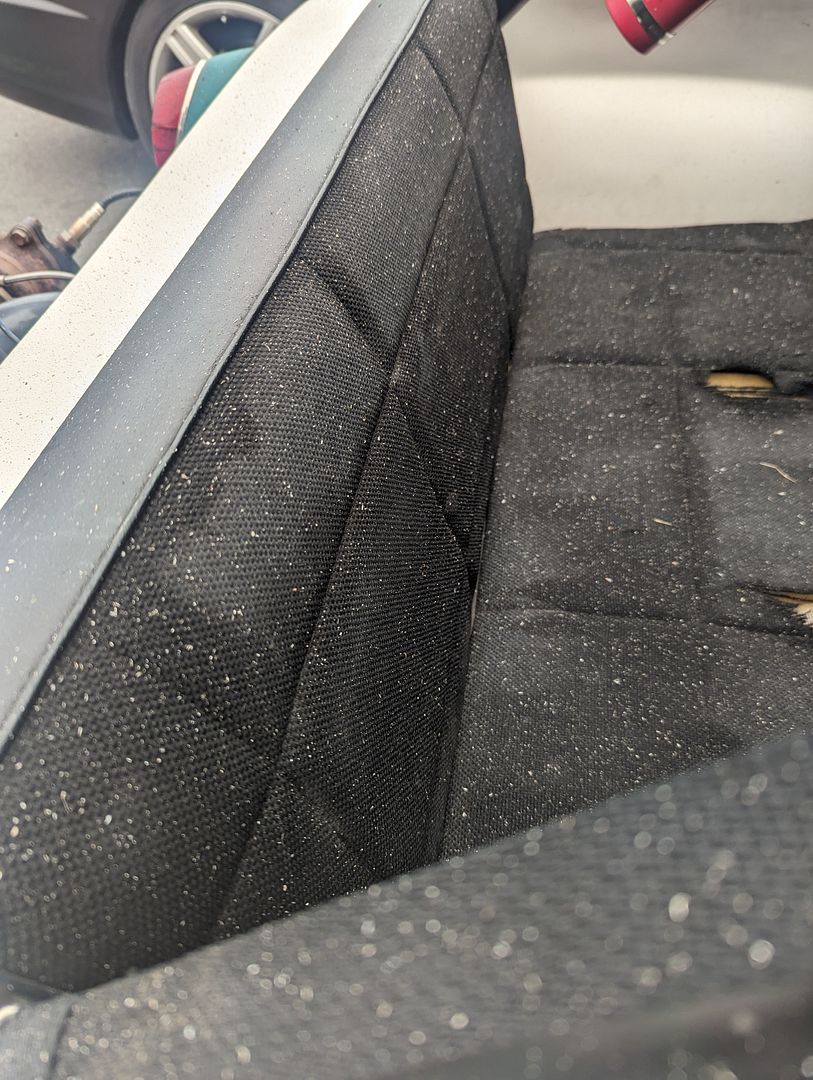

I forgot to cover my buggy with a tarp but did put the Bimini on and here is how much ash fell overnight.

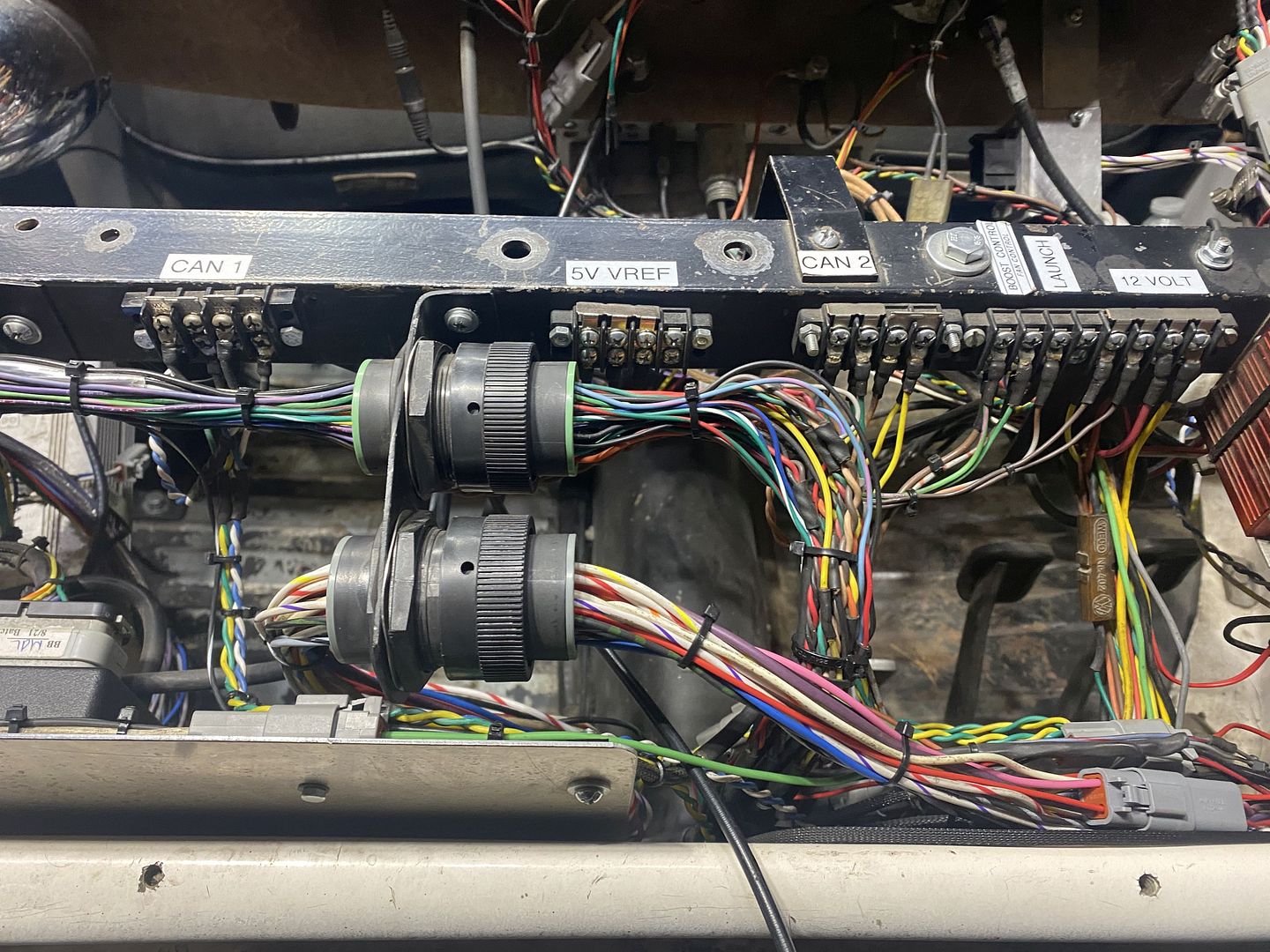

I have spent some spare time out in the garage when it wasn't too cold and I've rewired the PMU16 into a second HD20 Deutsch 31 pin plug. I have been able to clean up some of the wiring but without starting from scratch...I can't get it too pretty.
I did remove a bunch of the 4,6, and 8 pin Deutsch plugs to clean up under the hood. I might do some more later.
I was quite tempted to upgrade to the new PMU24DL but I'm have a tough time convincing myself it would be worth it. I would have to sell this PMU16 and the selling market is not that big.
The PMU24 would give me 8 more programmable outputs that I could put to good use. What it does is take eight of the inputs and make them inputs/outputs through the software. They can only handle 7 amps but that would be no problem for me.
Looking at my output screen the only thing that pulls over 5 amps are the headlights. The fuel pump pulls 3.5 amps but everything else is almost very little draw.
I could eliminate my VW headlight relay and the relays that run my water injection and and clean up under the hood even more.
Maybe I'll get a nice Christmas bonus that will allow me to justify the price.
Here is a pic of the new wiring.........
I don't have a decent pic of the before with all the other connectors.....oh well........it does look a little bit better.....
Not sure if I'm going to pull the body this winter....the engine has been running strong and the last oil change and valve adjust did not show anything funny. A couple valves were slightly tight and couple valves were slightly loose, there were no issues with the valve guides that I could see... all looked to be in place so I ran it again... I think I have a couple thousand miles on this oil change. Total mileage for the season was 4663 miles.
If I come across some money for an upgrade I might buy a nice set of ported heads from someone like SL-1 racing. That would be an interesting addition.....since I've never had any decent flowing heads installed.
I'm pretty happy with the output of the engine......anything else I do is just going to raise the $$$$ to hp ratio higher than it already is.
