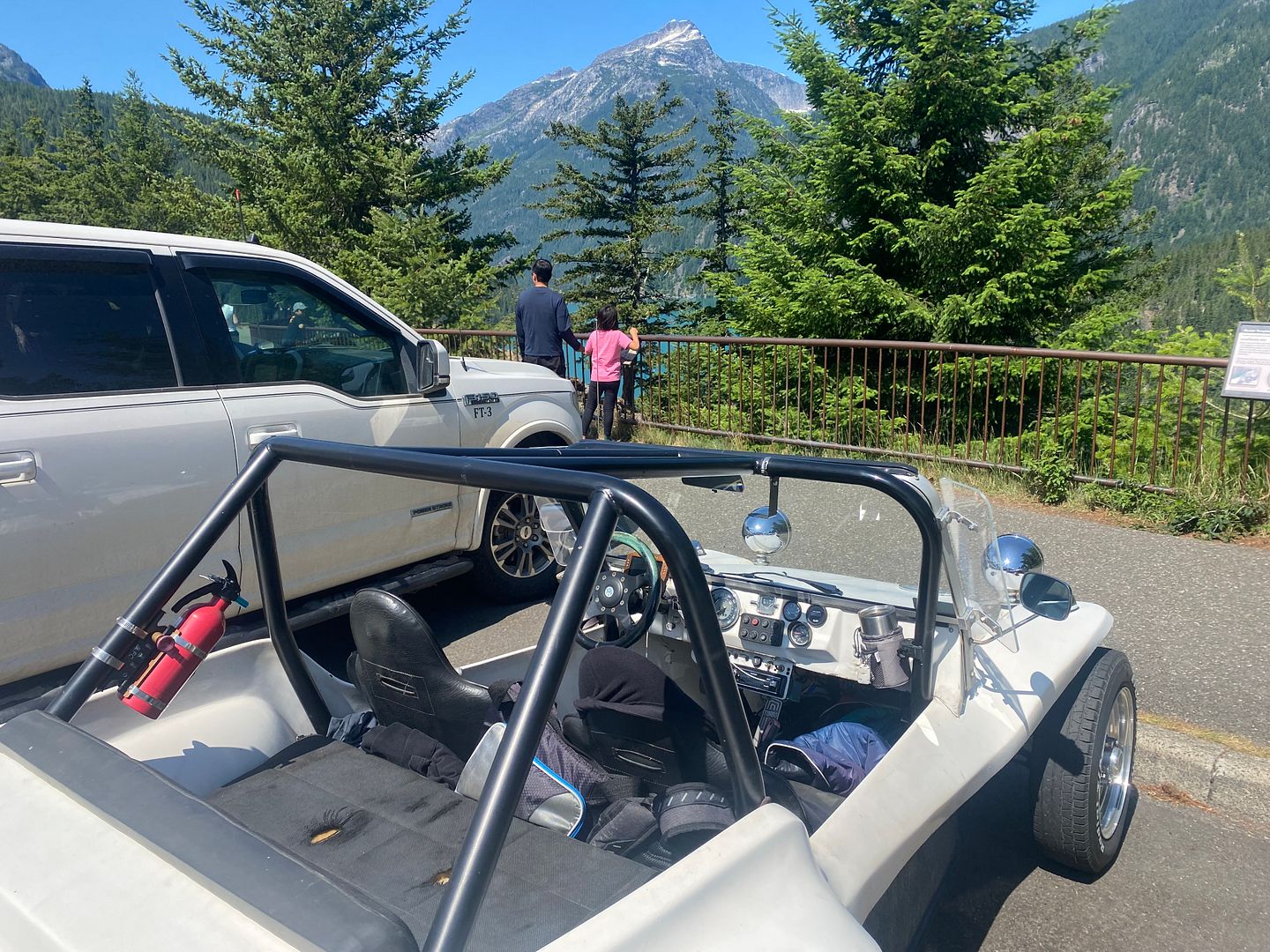

Stopped at Diablo Lake for the view.....
The buggy is showing it's wear on the upholstery. It needs new covering soon....
This is the view we get every time we stop.....

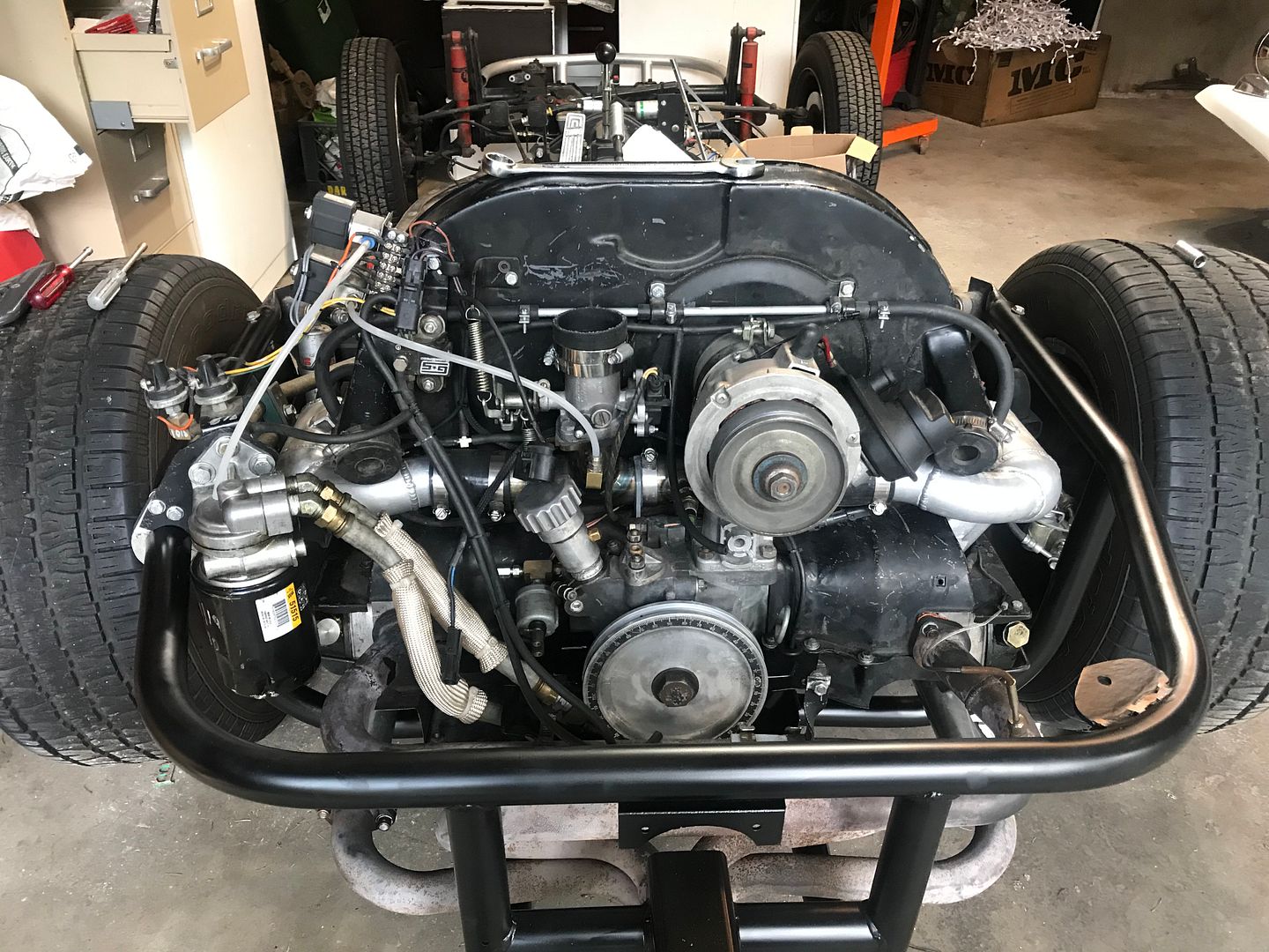

I already have a set of his earlier one off intake systems he built for me to fit my stock FI shroud. It was something I just had to have back then and it's been a nice system. I should have him flow test it some time.....but it is built on IDF FI intakes...... just with a plenum on top.
They were not really cheap you might say and getting the better half to sign off on another pair priced accordingly would be a challenge.......to say the least.
Here are the custom intakes........they've been on for 4 years now........
I added an IAC valve this past winter and just thinking about having to migrate all that over to a new intake............ which would have to go over the alternator brings a bead of sweat to my brow..........
