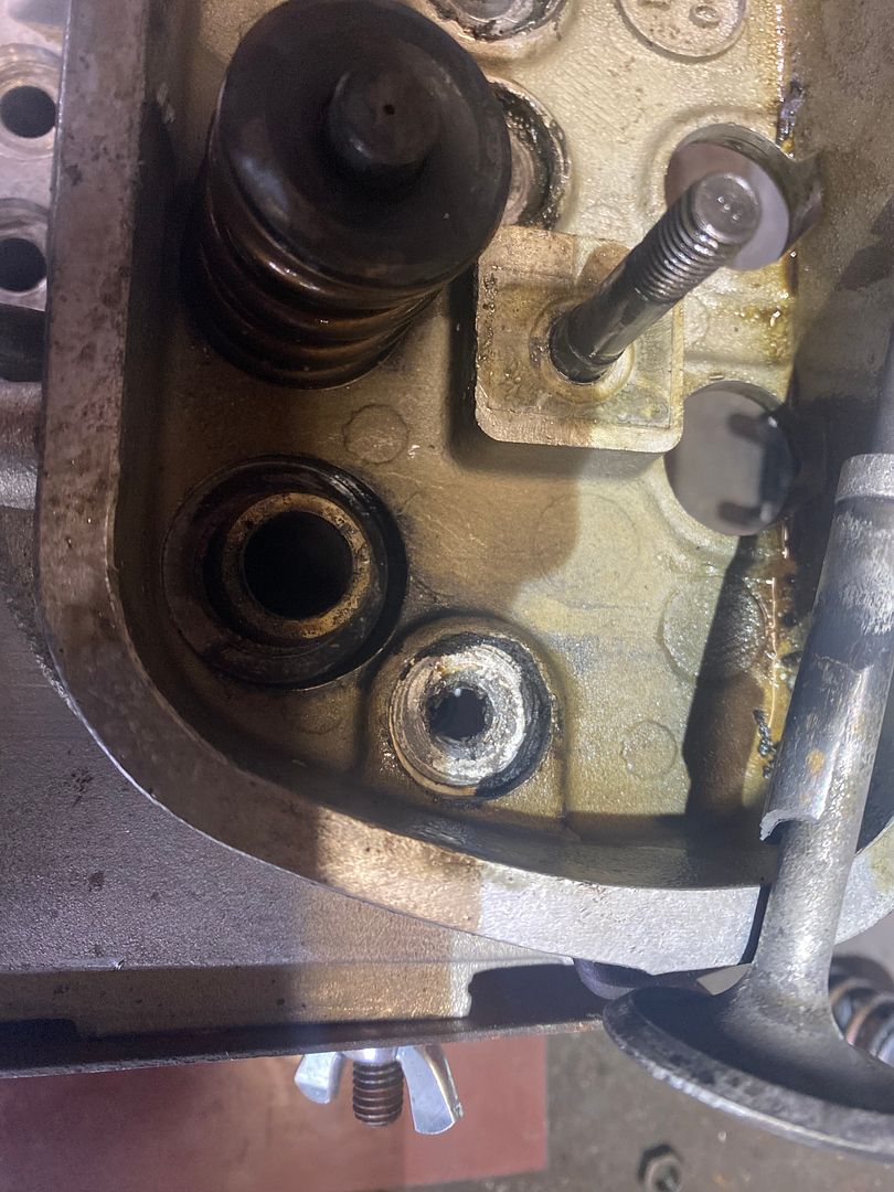

Update,
I've been working on the Buggy for a couple weeks since the weather finally warmed up a little bit. I pulled the engine and found the #3/4 head had some serious issues. The #3 exhaust valve guide was completely toast and the guide support was worn so bad the guide fell through and was bouncing on the valve head. There was a big piece missing but no damage to the turbine side of the turbo for some reason....
The #4 guide also was up about a half inch so the DRDs head are toast in my opinion.
I then pulled my stock heads off the shelf and disassembled them along with the DRD heads and swapped the CB 650 outer springs and cromoly retainers to the stock heads. Everything else looked good on the stockers except the small cracks between the valves but I'm just going to run them as is for a season.
We don't have a long trip planned so it should only be about 3500-5000 miles for this year.
I took the stock heads to the neighbor and had him cut 0.070" off the rocker pad and doing the setup on rocker geometry it came out so nice I don't need new pushrods. I have zero shims on the pads and the half lift and swipe came out so great I'm happy as it is. My adjusters are out 2.25 turns instead of 1.5 turns so it's still good in my opinion. The sheep's feet and lash caps show no abnormal wear in the 10,000 miles they have been on.
Valve lift comes out at .503" and cam lift is at .363" for a 1.39 ratio.
I did find one pushrod had rubbed against the bottom of a pushrod tube and worn a good bit so I had to order a new set of .035" cromoly pushrods to get one replacement. I'll cut that one to length and then finish up the engine and reinstall.

I never really noticed a gain with the DRD heads so I'm not concerned too much about any performance loss..

These DRD heads still have probably close to 32,000 miles on them if I have to guess. They just needed a lot of work in those miles.
Cheap valves, cheap guides and who knows what else. They are the 049 head casting but for some reason I've had no luck with them.
Some of this last problem could have been self inflicted but I can't say for sure.
I did do a LOT of idling setting up my IAC valve this winter due to crappy weather not allowing me to drive it after a start. That could have been a part of the problem but I don't know.
The guide support on the #3 cylinder is worn to almost 3/4 inch diameter while the guide is maybe 1/2 inch diameter. There was aluminum everywhere in the valve cover.
Maybe my EGT's are too high......I don't think my gauge is very accurate since I bought a new probe for $12.00 a few years ago and might not have it calibrated correctly. At rest EGT temps do not match the IAT or oil temp sensor before starting so I have some reservations on accuracy.
The DRD exhaust valve do not look like they were run too hot so it's hard to tell what caused it.
I'm going to run it for a season with the stock heads. They have held up very well and never seem to have a leakage problem since the intake ports are spotless whereas the DRD's had black soot from reversion all through the intake ports so I know they were leaking. When I had my Builder put new guides and valves in them last time he went through them it solved the leaking issue and they seemed to run good.

Here is a pic of my toasted valve guide on the DRD heads.......
You can kind of see the enlarged hole for the guide if you look closely....it's probably an 1/8 inch larger diameter than the stepped part of the guide since it fell right onto the valve head and rode there for who knows how long.
