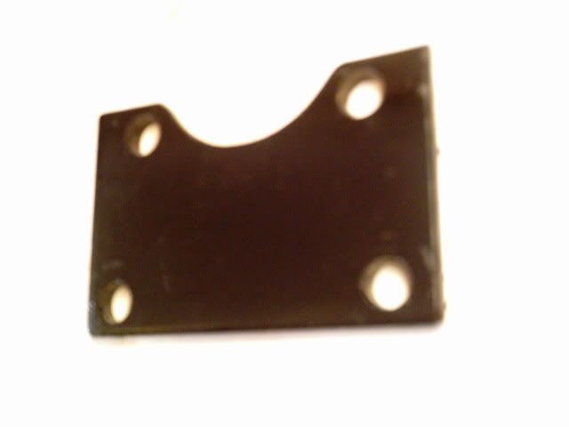

To mount the calipers I'm going to make a bracket, again similar to VDUBCUSTOMS
this means losing the splash plate ........but so what!

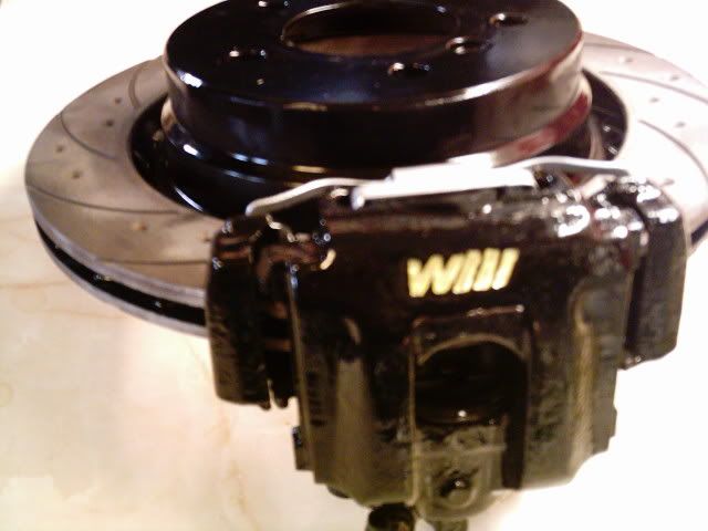

At the rear I'm going to use a turned down drum' as the hub and mount the disk over it. This'll increase the track by about 8mm easch side but with the offset on my wheels I'll still have plenty of space between the tyre and fender.
These pic's from the AIRSOULS website give you an idea of what I'm planning.......
the bracket for mounting the caliper will look 'something' like this....
