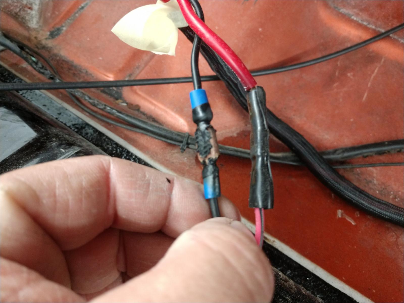

Got the bottom of the car blasted, undercoated, and painted today. It was hard to pull the fuel lines and water lines, but i did it anyway. Had to pull the fuel tank to get to the lines and found that my pump seal has been leaking. Then found my ground connector appears to have gotten hot. Not a good situation! I'm going to order a few good connectors so i can just unplug some of this stuff more easily next time. I will put a bigger ground wire on when i do that and hope that takes care of it. Time to put a fire extinguisher in the car too!
Tomorrow I'm going to go back to work and put the fuel line and water hose back on.

Re: 2176 this time
People don't seem to understand the importance of the ground wire. It should be at least of the same gauge as the wire or wires it is supporting. Not a big fan of those slide together connections ether as they have a tendency to come apart easily and sometimes drop and short out causing other untold problems :roll: :lol: .

Post by buguy »
I dont like them either. Just what i had at the time. I will be ordering some proper connectors this time around. Especially since all 3 connectors i need are high load. Fuel pump, heat exchanger fan, and water pump. I think I'm going to use Deutsch DT connectors. They are good for 13 amps per pin. May be overkill, but i like that better than underkill!
