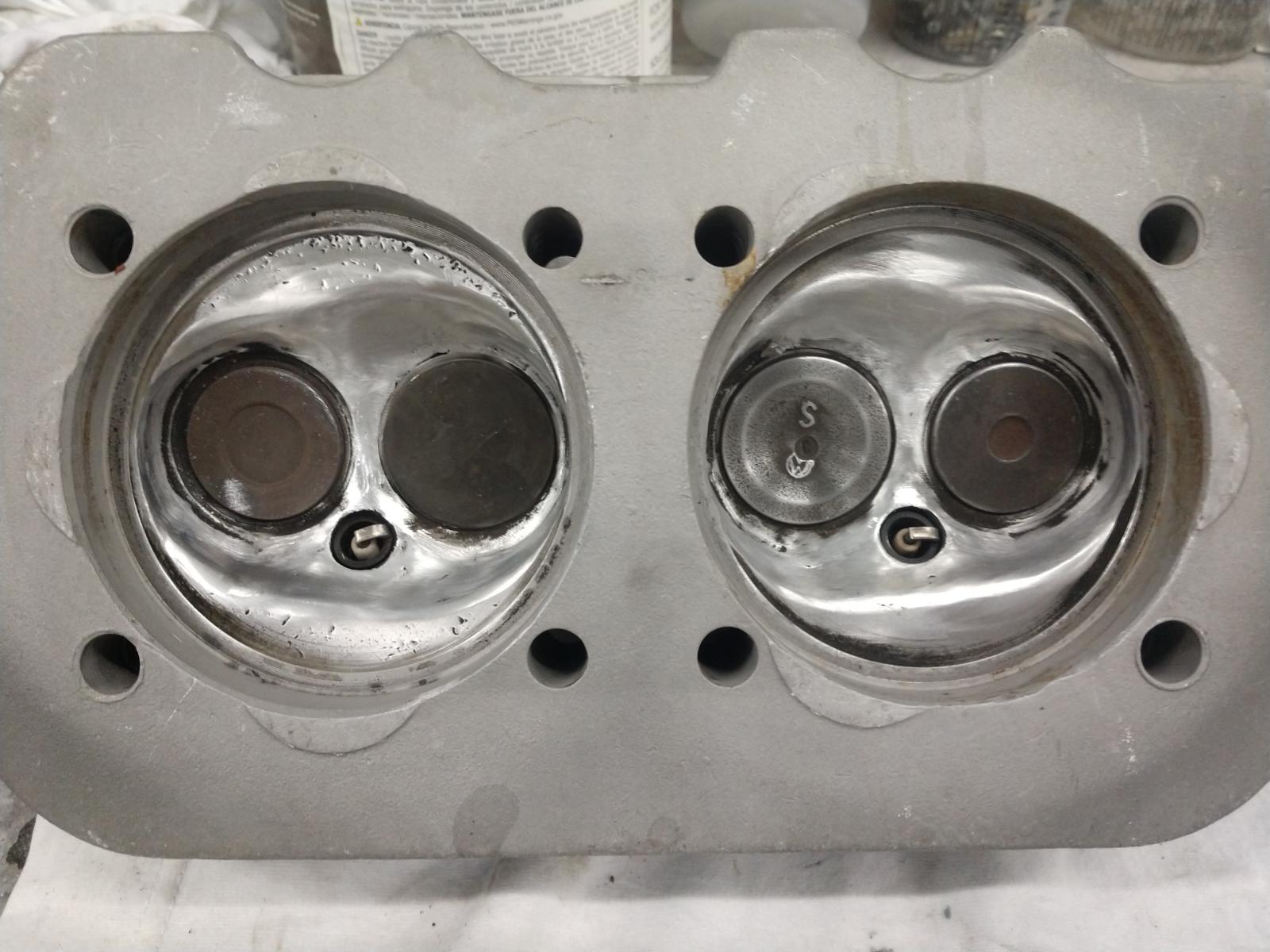

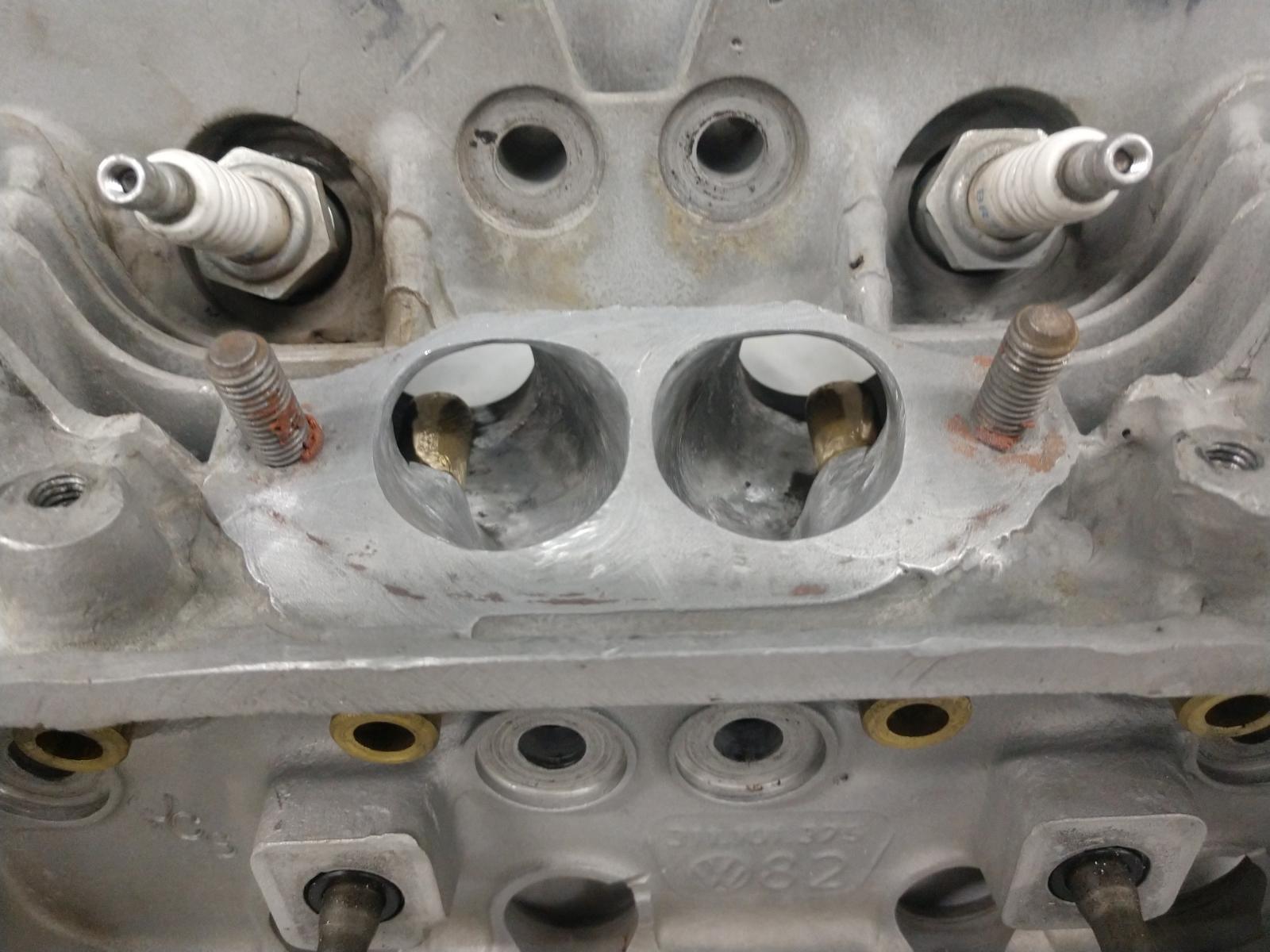

Here is what I did to my heads. The intake ports weren't quite finished in that pic, but that's what I already had loaded on the samba. It was close enough to done to see what I did. Keep in mind I did very little research on it, just did what I thought was right. Check out how all of my valves are different! Quality units!
