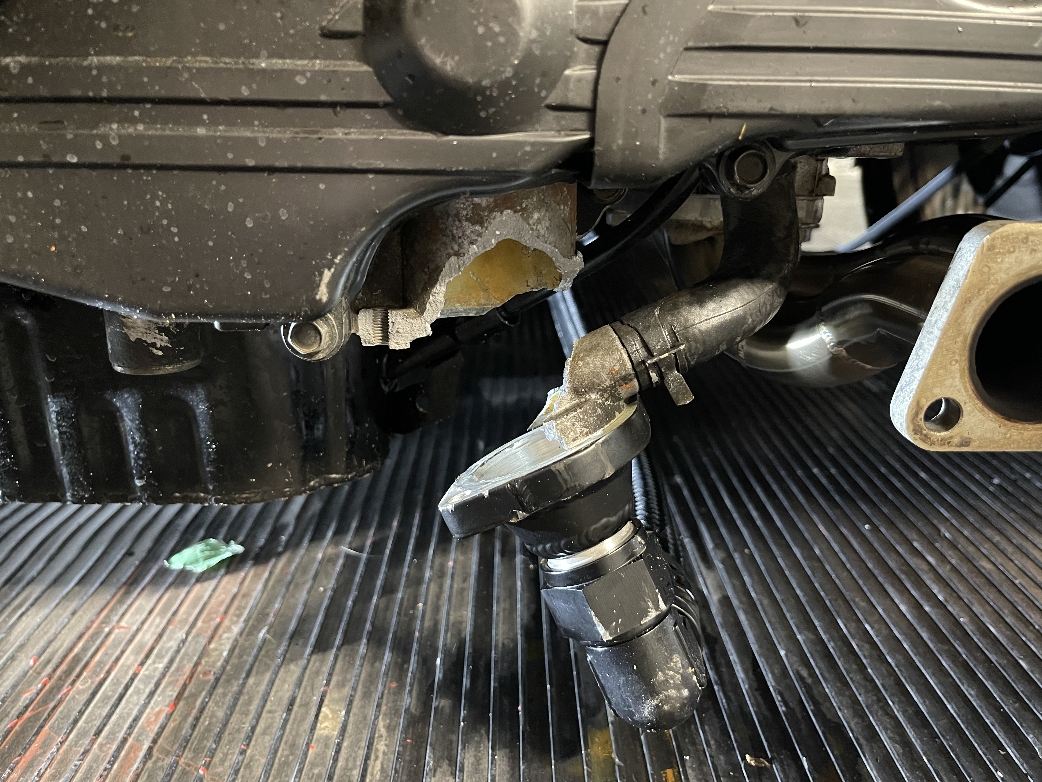

Love your car. What have you done there with the t-stat housing ?
72marinablue
Posts: 22
Joined: Sun Apr 24, 2011 11:00 pm
Re: 72 Beetle EJ22 Build
Post by 72marinablue »
panel wrote: Wed Aug 17, 2022 4:22 pm Love your car. What have you done there with the t-stat housing ?
Thanks! My first fabricated thermostat housing didn't go so well. I used AN lines for my cooling lines so I needed an AN bung thermostat housing. The first one came straight out the bottom and I used a tight 90 degree fitting to send the line forward. This ended up hanging way too low and I smacked it on the first test drive. Luckily I was close to home as all the coolant fell out of the car. The second design I machined a pocket and flange from aluminum and the AN bung comes out of the side so I have way more ground clearance. It now sits higher than the sump.
panel
Posts: 4229
Post by panel »
Looks like a great simple solution , well done !
