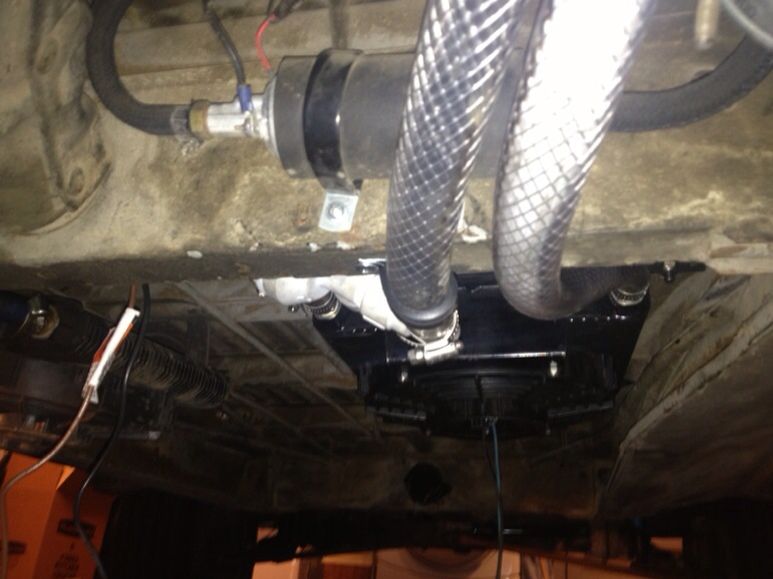

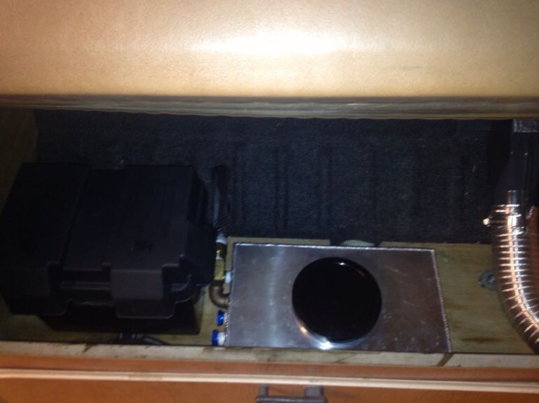

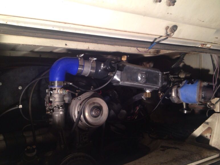

Quite a bit of progress on the bus lately... Ordered a set of entry level turbo heads from DRDracing after the old stock heads that had been rode hard and put up wet spit a spark plug (and another plug you could wiggle by hand). That was the nudge I needed to upgrade to some big valve heads. 40 x 37.5 valves, dual valve springs with a mild fluff and buff on the intakes. I have to say these are probably the nicest heads I've seen right out of the box. When the bug needs some new heads I'll definitely go back to DRD for some of his higher end heads. With the new heads it immediately built 12psi before I let off :twisted:
So that was a good sign to finally solve my dilemma with only being able to build 8psi. Problem is I still can't really build much more without detonation. So a water/air intercooler was in order. Got the parts in and started installing it last night and finished it up tonight. Still have a little cleaning up to do and need to test it out tomorrow. Can't wait to see what kind of difference it makes...........

Good work!
The radiator looks neat, what's it from?
Gill.

Post by Zander »
Thanks for the kind words. It's just a standard 96 plate oil cooler that a lot of people sell http://www2.cip1.com/ProductDetails.asp ... C13%2D9293

Post by vwgillybilly »
No probs. I should've spotted that really - I use one myself!!!
