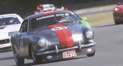

I want one of these front spoilers --- I hope I don't have to make one LOL

FJCamper
Posts: 2910
Re: Karman Sutra
Post by FJCamper »
Hi Fiatdude,
We both have the same front bumper, and an effective airdam can be attached to it. Also, the RSR-type ducktail is easy to make.
FJC
Fiatdude
Posts: 971
Joined: Mon Oct 12, 2009 6:58 pm
Re: Karman Sutra
Post by Fiatdude »
That front air damn looks cool --- can you share more pictures of how it is attached and the material used
Thanks Harold
