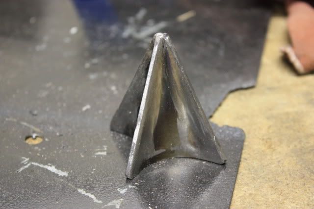

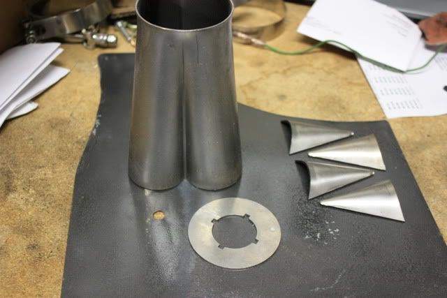

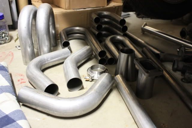

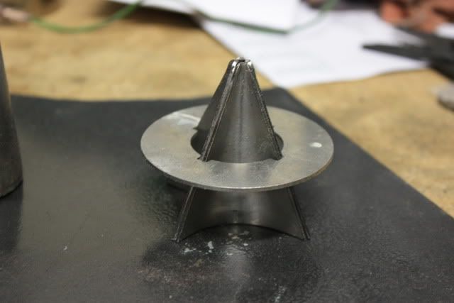

I guess it is time to start building a header and exhaust.
I got this nice merge kit from Cone Engineering.
Put the jig on.
All welded and cleaned up.
More to come!

Nice, I really enjoyed building my header. You still need to add some slack to those fuel lines :wink: I would hate for you to rip a fuel rail out your first trip out.
where did you get your tubing?
[email protected]
WickedWagens
Posts: 775
Joined: Fri Sep 02, 2005 9:33 pm
Re: Mark's turbo ghia buildup.
Post by WickedWagens »
MarioVelotta wrote:You still need to add some slack to those fuel lines :wink:
I know, I know. It is on the "list". Hope you don't mind, but I am stealing some of your header design.
I got tubing from SPD, Columbia River Mandrel Bends, and Megs exhaust.
I needed bends in 2", 2.5", and 3" radius.
