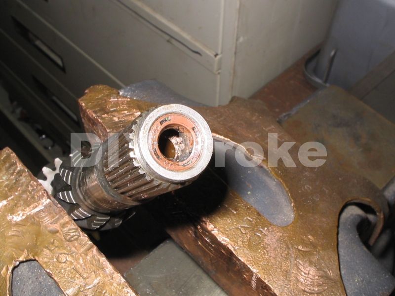

Yes Ray, I got this lead from you. Same part right?raygreenwood wrote:The throttle body of a 2.0 bus had those seals. The seals I have found that fit....are the seals that come from water cooled golf and jettas and go around the throwout bearing pushrod in the transmission. They are about $3 each at VW dealers. Ray
020 main shaft with clutch pushrod seal inside
How did you install the 020 part since it has smaller OD than the 022 bus part?

yep..thats the seal...from the 020
Since the throttle shaft centers itself in the bore...I simply sprayed the outside of the seal with a dry film mold lubricant (silicone or Urethane based will not matter)...then pushed in a nice smooth bead of JB-weld around the seal edge. Cleaned it up nicely before drying.
Just for the heck of it I hooked the seal out to see if it would come loose or was in tight. It has nice thumb pressure ...press in tension on it. Ray
