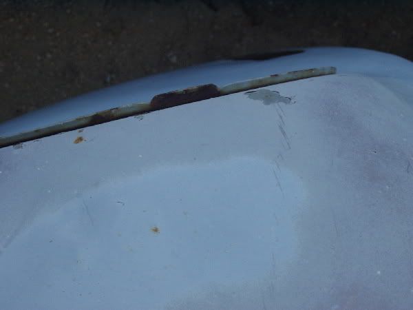

I can explain what's going on, but a fix will depend on what you want to do. The stock bug metal fender has a lip under the top that the trim ring catches on, and the screw keeps the bottom of the ring in place. I can snap a pic tomorrow in daylight to show what I mean.namelesswonder wrote:Oh, question: how do you get headlight trims to stay on? There's just that one hole for a screw...but I put them on and they just fall forward. Is it because my fenders are stock? Or is there some trick?
Edit: It's tomorrow! Pics:
Your (non-stock) baja fenders don't have that lip to hang the trim ring onto, so you can either:
1. Do nothing, run the lights as is without the trim
2. Drill holes for additional screws holding the trim into the fiberglass
3. Glue the trim rings into place with some kind of RTV (sleezy).......and hope the headlights won't need changing for a while
4. Mount the headlights a different way with buggy style buckets on tabs welded to the beam
5. Fabricate something like the stock setup
6. Sell the baja (most desperate option)
