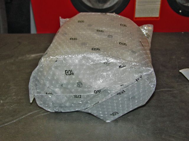

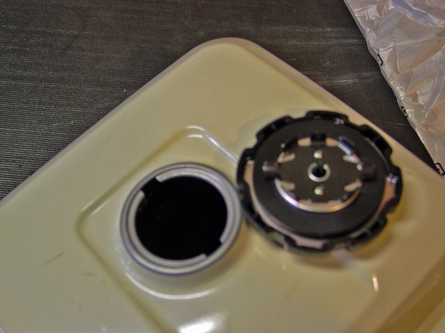

Well, well, well, I got a call yesterday from my local Honda dealer, at closing time, informing me that the tank I ordered was in. They said 5 to 7 days and it was 5 working days. The guy came out with a nice sized Christmas box (something that can be used for putting no box Christmas presents in) that wasn’t damage at all.
The tank was wrapped thrice in foam and bubble wrap to protect it.

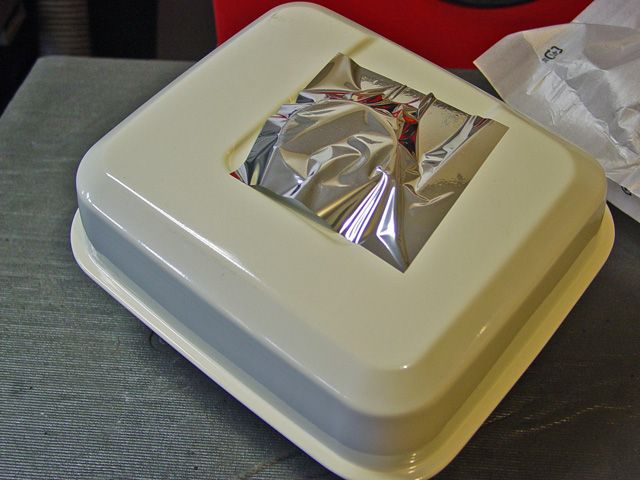

This is how the bottom looked as I open the last layer of the tank condom. The first thing I noticed was metal tape covering the outlet hole; this drew my attention away from the second feature that was important, a threaded hole in the side of the mounting surface.

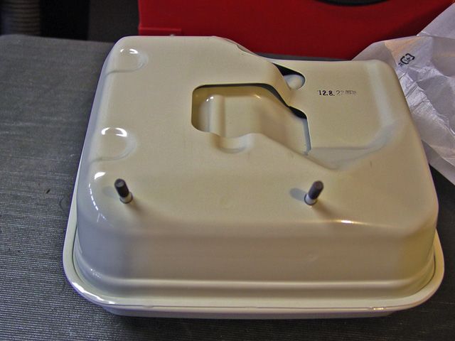

These are the other two mounting studs… at an angle. There is going to be some plain and fancy hammer work in the big city soon folks.

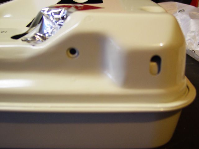

This is the threaded outlet hole. Some of the pictures I have seen showed the tank with a spud mounted but this way, assuming I can get what I want, I can extend things out and put a shut off/drain valve on it.

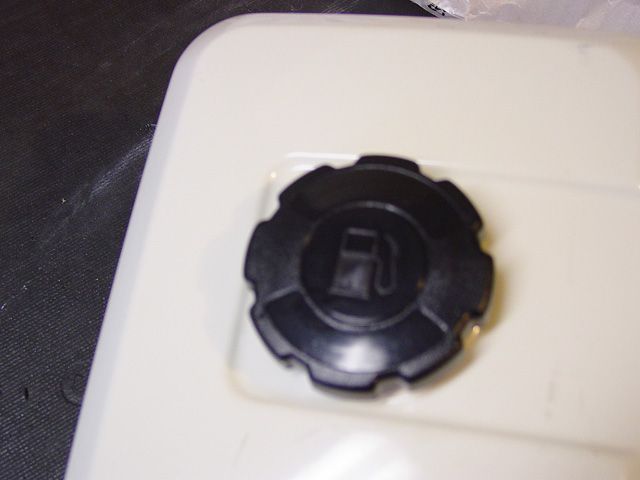

Again, the tank fuel opening was closed with metal tape. The fuel cap is sold separately.
The completed tank; now I have to figure out how and where to mount it. I want to mount it high enough for gravity feed in case the stock fuel pump should fail; one of the reasons so many sand rails mount the tank high in the car.

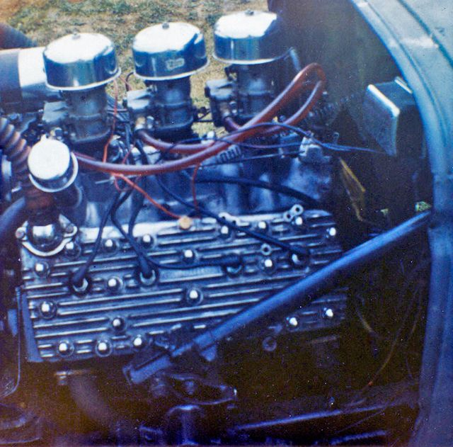

bugman742002 When you posted the switch you got me thinking back about 50 years.
You can't see it well here but on multiple carb setups we used to use a single line tee'd for a line to each carb or a fuel distribution block with ports for the number of carbs you were running. I'm beginning to think a distribution block might be a good direction to look into. I also got thinking that I have an extra brass rear brake line Tee that might work as a fuel block to the engine and to a drain shut-off valve. I would have a shut off between the tank and the Tee then a secondary shut off for a drain line so I don't have to worry about it dripping from capping it off. More complicated than I wanted but less electronics I have to deal with also.
